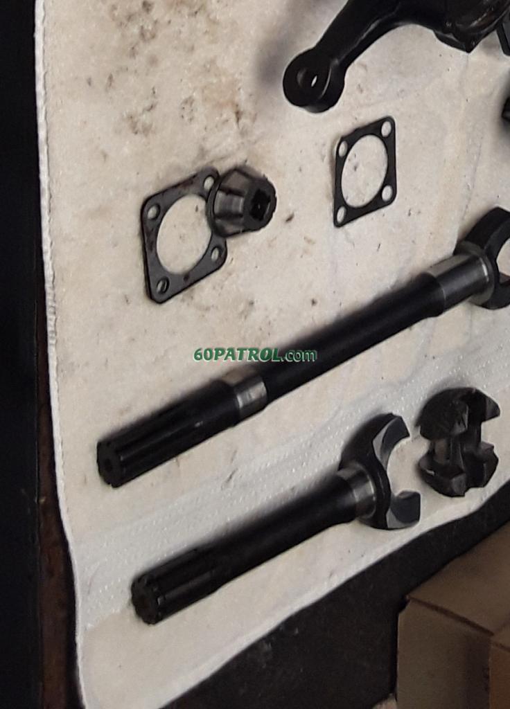

rdarnell wrote:I did not take any pics of them but I was able to crop the photo but not sure they show much detail. The had some wear but the cone and the tapered bushing both looked smooth with no uneven wear.6374
6375
Is this ball and claw and corse spline like old land cruisers?

Yes it is. My fathers cj3 jeep also has this setup. The formal name is tracta joint.
