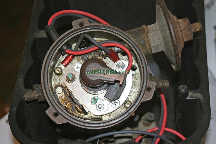

Great! Thanks for the Help. Would yall be able to send photos of the installed 1763ls and it connected to the coil?

Re: 1969 Patrol, Distributor?
