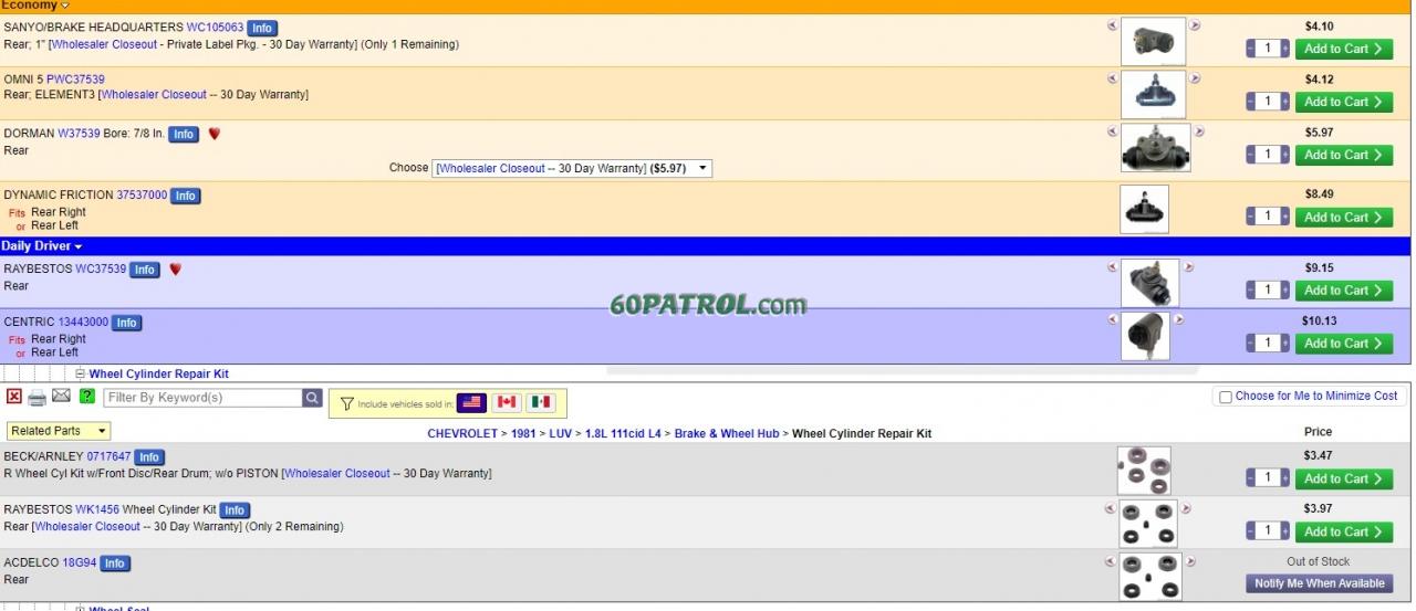

Per RockAuto, the rebuild kits above are for the CHEVROLET 1981-1982 LUV and 1988-1992 ISUZU PICKUP. The kit includes "Spring, Boots, and Seals", but no piston.
As an alternative, perhaps buying a CHEVROLET complete wheel cylinder and removing the new piston, seals and boots will allow you to refresh the entire Patrol Wheel cylinder.
Here are the Chevrolet wheel cylinder part numbers for reference.
Hopefully, these rebuild components are DOT 4 compatible!
