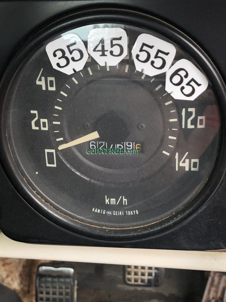

Here is one redneck solution I used. As I recall someone on here printed new faceplates up and they looked great. Maybe someone with a better, less medication addled memory can find that post.
It might be possible to swap the faceplates but it would be an incredibly delicate job and could compromise the function of the meters. Knowing the talent of who you have available to work on them I personally wouldn’t jeopardize the gauges.
