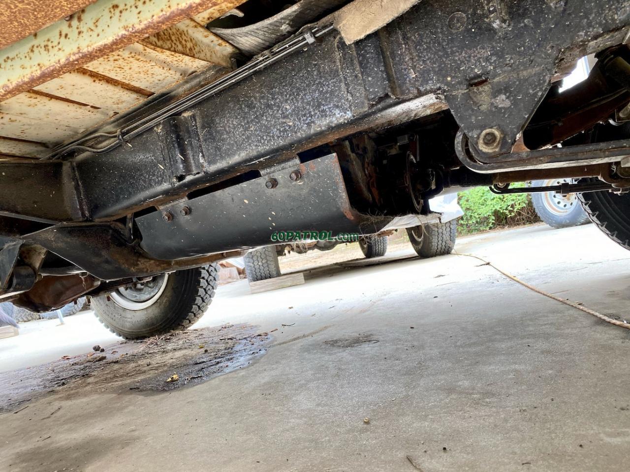

ive noticed under my patrol......under the transfer case, transmission .....there are brackets on each side of frame indicating something was
bolted there....like a bottom plate protecting transfer case from bottoming out...?.....why oh why it was never replaced....is one for the ages...im next to sure thats what was there and im wanting to buy the missing part......please...lets make a deal.......hoyt

Those brackets are for mounting a skid plate which was optional.
