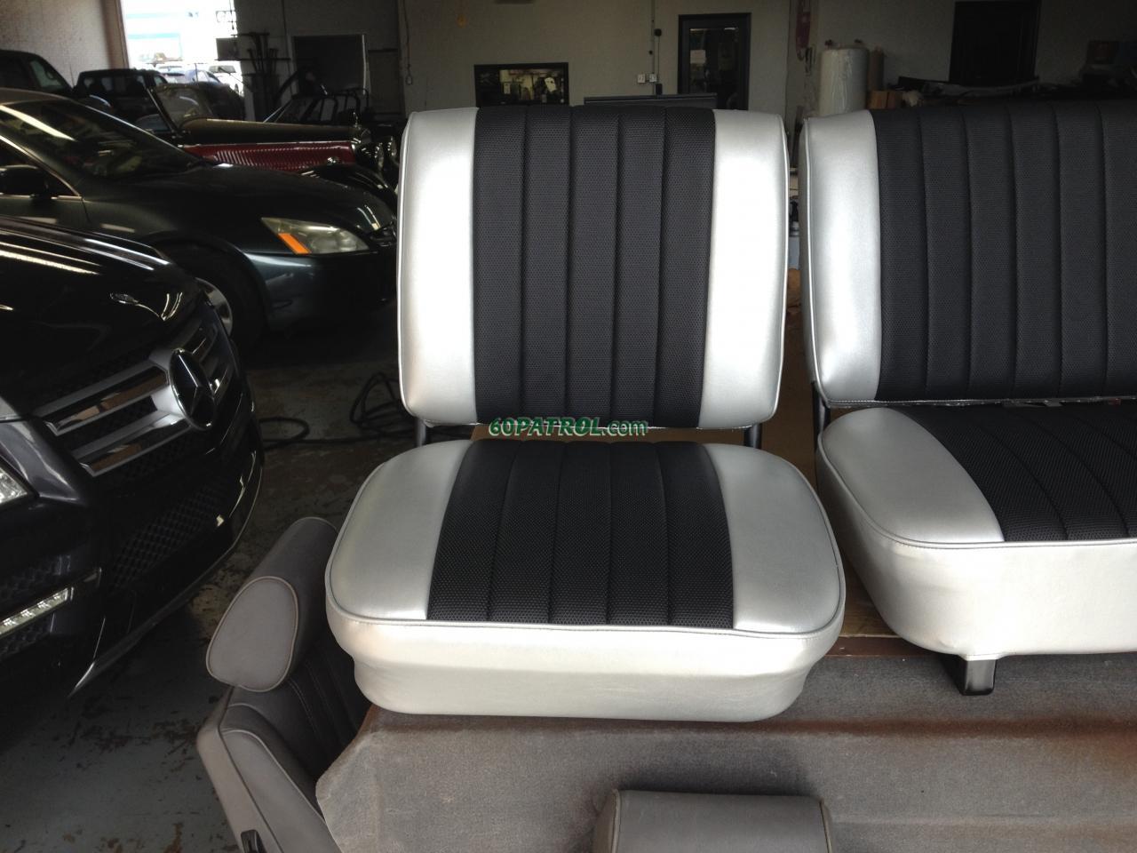

You mentioned body-colored wheels as part of “deluxe” options.
What else was considered “deluxe”on a Patrol?

Flaggoni wrote: What else was considered “deluxe”on a Patrol?
black and silver two-tone seats

Deluxe
5454
5456

"68 - '69 only. Hey, there's the seat that Jason needs! :lol:
