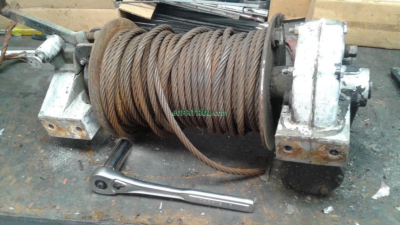

Anyone have the correct koenig winch on their Patrol that could provide me some dimensions of the metal cradle holding the winch? I have recently purchased a Koenig C-100 and need to build the cradle that holds it. Most of it I can figure out once I hang it on the frame rails but if i had the front and rear angle iron sizes it would make for a great start. here is what I have.5768
And this is what it should look like5770
What I need to know is from the back side what is the size of the angle iron ans the thickness. I also need the center of the bolts from the top. the back pieces should be the same size metal but not sure about if the bolts are the same distance from the edge as the front plate lays on the bumper and the rear does not. here are some of the dimesions I need. 5771
I live in Louisville Ky, if someone has one I would love to come look it over.
