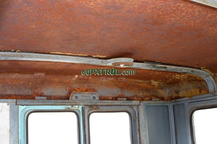

Not many of the Patrols that I have seen still have their original headliner intact. Some have sagging, tattered remnants left, especially if they have sat out in the elements for a couple of decades. There might be just enough left to clip out a sample to match the original materials. If there’s none left, then what you have is a ceiling full of ancient, deteriorated, flaky foam and rust, most of which lands in you hair and lap while driving the trails.
The ’69 Patrol that I use regularly for the trails was a prime example of the latter. Even after I brushed off as much of the old foam and rust as I could, a good hard bump would have the stuff dropping in my eyes. I quickly got in the habit of wearing a hat for survival. Every time I hit a good bump, or even if the wind was blowing hard, the roof would pop and bang and oil can so much I couldn’t hear the rest of my rattles. Makes me nervous when I can’t hear all my rattles – that might mean something fell off.

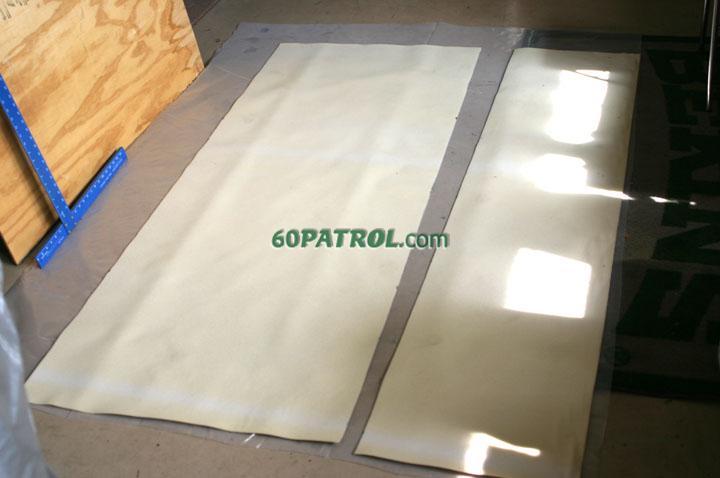

Roll the headliner material out on a flat surface. Measure 6 feet (72 inches) of material, and cut across the entire length. The headliner is actually in 3 separate sections, each of them a different width. This makes it much easier to install and work with. We’ll start with the rear section. The rear section is 17 inches wide, so measure 17” across the entire length of the 6’ section you just cut. Draw a line with your marker and cut the rear section. The center section is 30 inches wide, so do the same thing to end up with your 30” section. You are left with a section that’s about 7 inches wide. Save it, you can make use of it later.

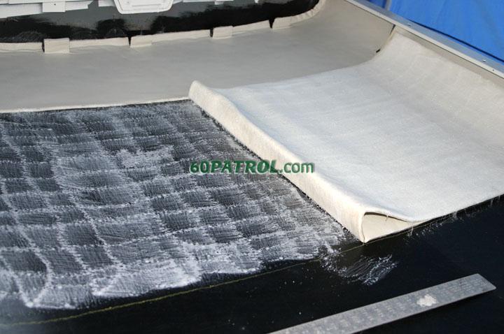

So, you’ve got the material centered and you have your chalk line drawn. Fold back half of the headliner material, like you did when gluing the foam to the headliner. Spray a good coat of the adhesive on the roof, remembering to get up along the sides. Now spray the exposed back of the headliner section. Let your glue dry for about 15 minutes.
Once the glue is ready, put one hand inside the fold of the headliner section to hold it in place. This will also be the hand you use to spread down the headliner. With your other hand, pick up the end of the headliner. While holding the end up, spread down the headliner, smoothing and pressing as you go. Watch the inner edge of the headliner to make sure it stays along your chalk line. Don’t worry so much about the panel tabs at the rear yet, your goal is the side. Spread and press from the center towards the sides, still holding the end up. You don’t want that end dropping because it’s going to stick where it lands. When you get to the curve just before the side, give it some extra pressure to make sure you get it all the way down into the curve. Now press it up along the side. Go back over it to smooth it out, but by now any wrinkles are there to stay. You can either do your trimming now, or wait until you get the other side done.
Now, repeat the same procedure with the other half.

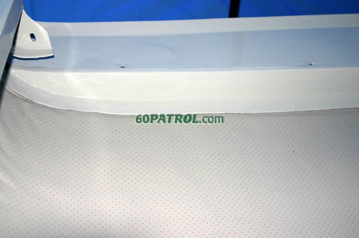

When you glue the ¼” foam to the headliner material, you want to have a 1 ½” gap between the edge of the foam and the edge of the headliner material, with the headliner material overlapping the foam. This way it won’t be too thick when you go to tuck the headliner material under the front edge of the roof. So, glue you foam to your headliner material with this in mind. Be careful not to get glue on the front overlapping edge of the headliner material. You might want to tape it off.

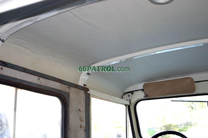

Okay! You’re headliner is finished! Stand back and admire it. But, the job is not done yet.
You need to put the support bows back on know, and put the roof back on the Patrol. All I can say is it’s not going to be easy to put the bows back on. You’ve got all that foam padding now that are going to make things difficult to fit back on. You can try to put them back on while the roof is still off, or once the roof is back on the vehicle. I ended up doing it when the roof was back one the vehicle. Since this is just a headliner tutorial, the rest is up to you.
A little added touch that is nice is to use the extra headliner material to line the fiberboard panels inside the Patrol. The remnant left from cutting the rear and center sections will work perfectly for the panel that mounts in the rear of the roof. Just use the adhesive like you did for the headliner material, notch the edges so they fold over nicely, and viola!, you have lined trim panels.

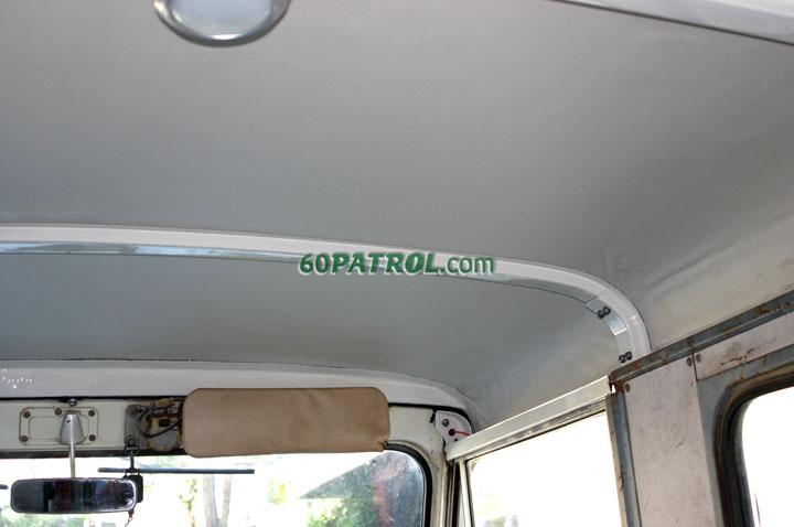

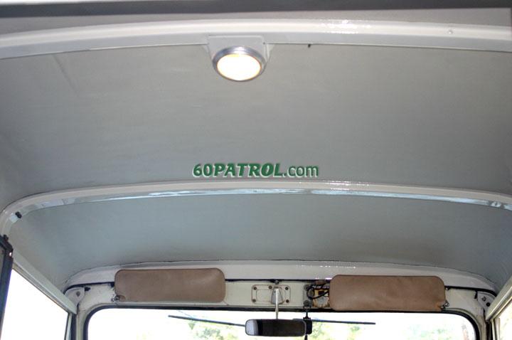

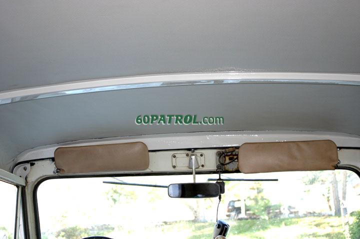

Here’ the finished product. Not perfect, got a few wrinkles in places, but much better than what was there before.
