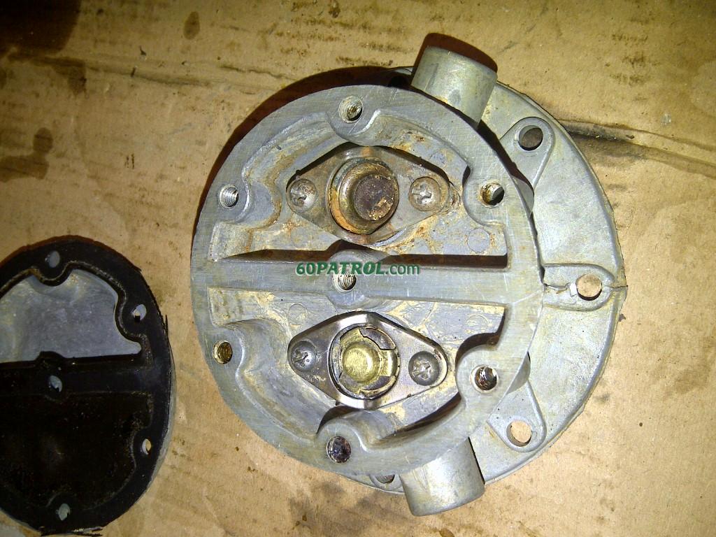

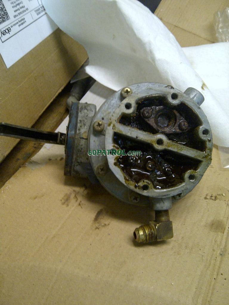

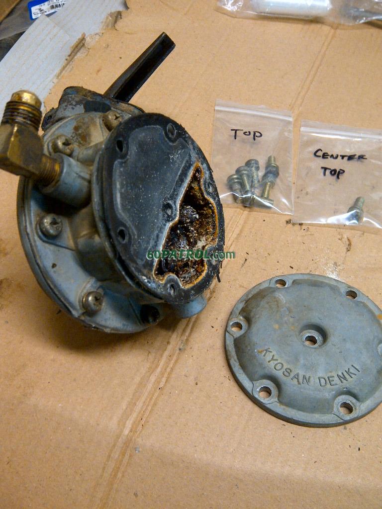

Today as I stared at the original pump, I wondered why the PO cut the lines and installed a cheap non-functioning electric pump. The original pump looked good. Well, curiosity got the best of me so I removed the pump and opened it up. I spent about an hour cleaning the mess from inside the pump and 45 degree pipe. I will put it back together in the morning and see if it works. I think it may be salvageable.

Yikes! :shock: :o No wonder the carb was replaced. :roll:
Did you take apart the bottom section to inspect the diaphragm? That is another possible failure point.

This is a nice photo journal of this process. Baggies, sharpies and photos are the best reminders. Keep on it! :clap:

Yes, took it completely apart. It was a mess. I reassembled this morning and bench tested.....success!!!! Unfortunately, the hard pipe from the pump to the carb is clogged also........uggggg. I imagine the pipe from the pump to the tank is clogged also, not to mention the tank itself. I plan to drop the tank next weekend and send to a shop for thorough cleaning.
I've always used baggies/marker to keep things organized. Also take plenty of before and after pics with the cell phone just in case.......:)
