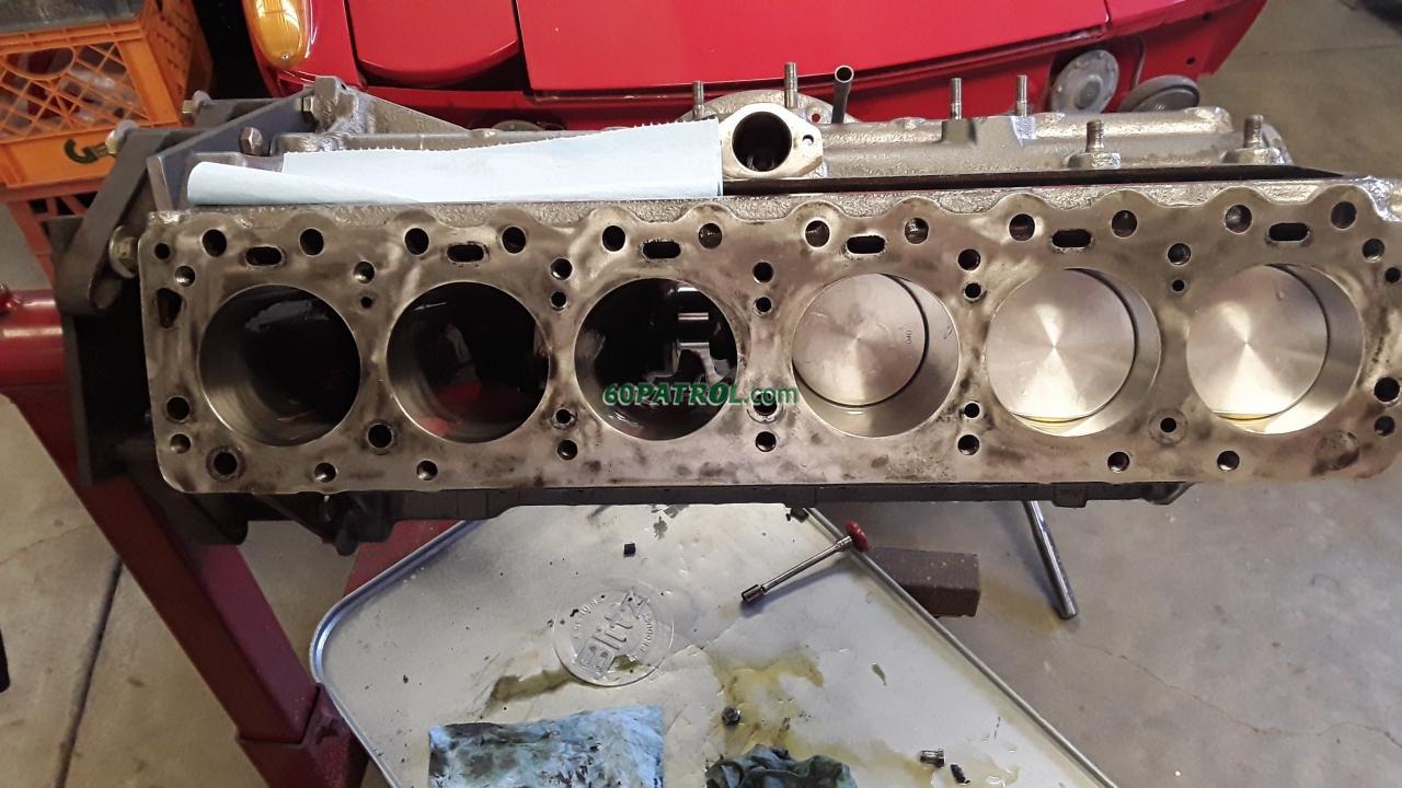

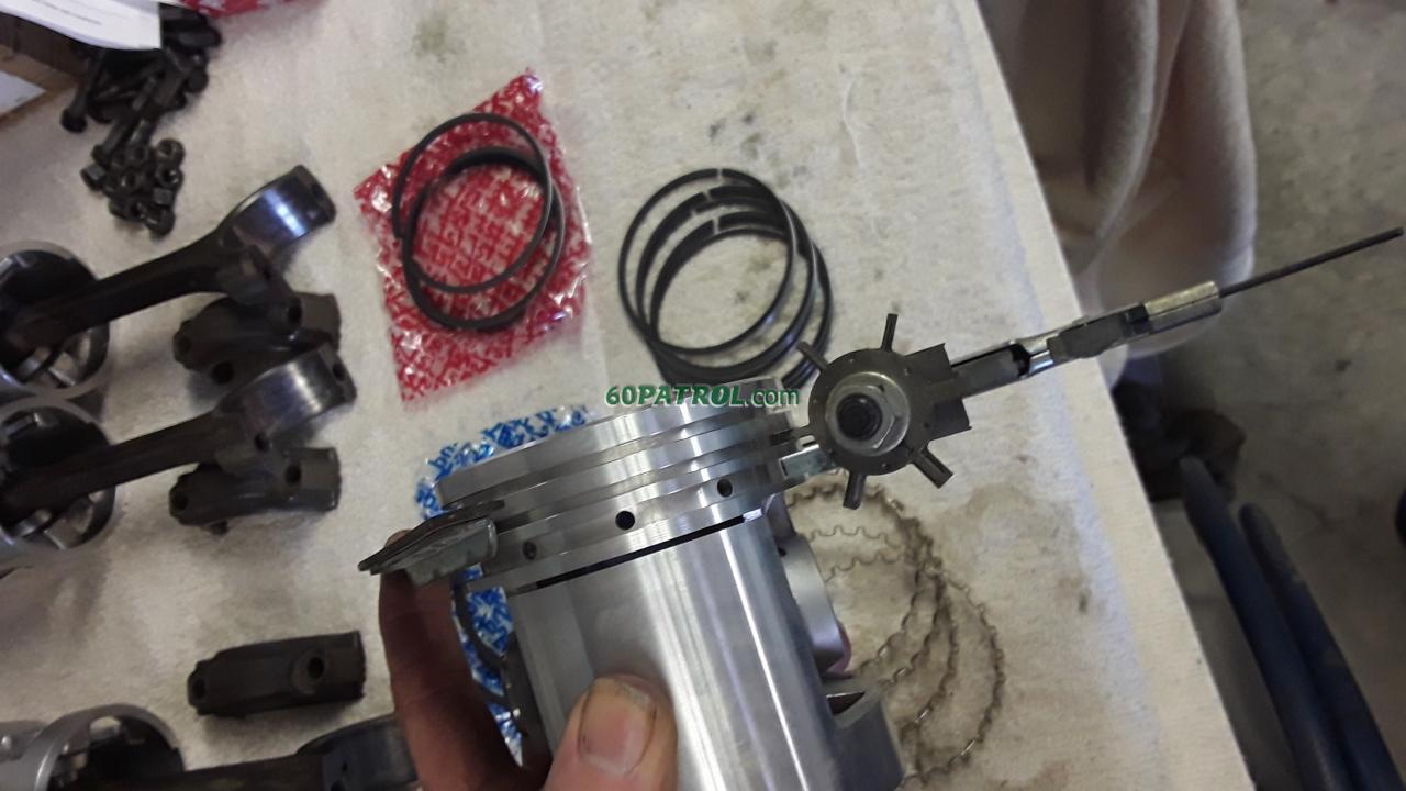

Today I had a little time to get the rings on the pistons and the pistons installed. I checked the ring grooves on the pistons and found one to have a small nick that caused a tight spot so U used my ring groove tool to clean it up.
6938
6935
The pistons have a F on the side near the wrist pin that signifies front. The rod caps have match numbers on them that will be facing the cam side of the engine.
6935
6937

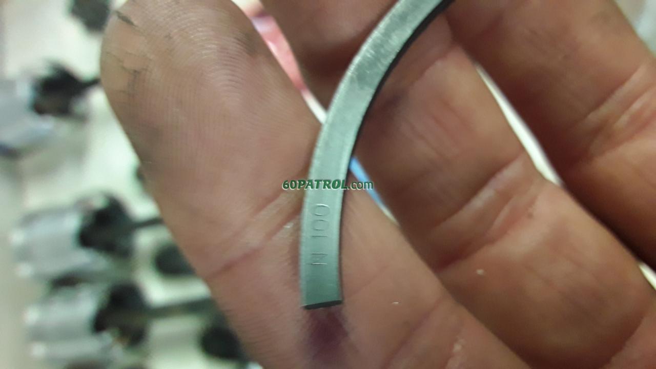

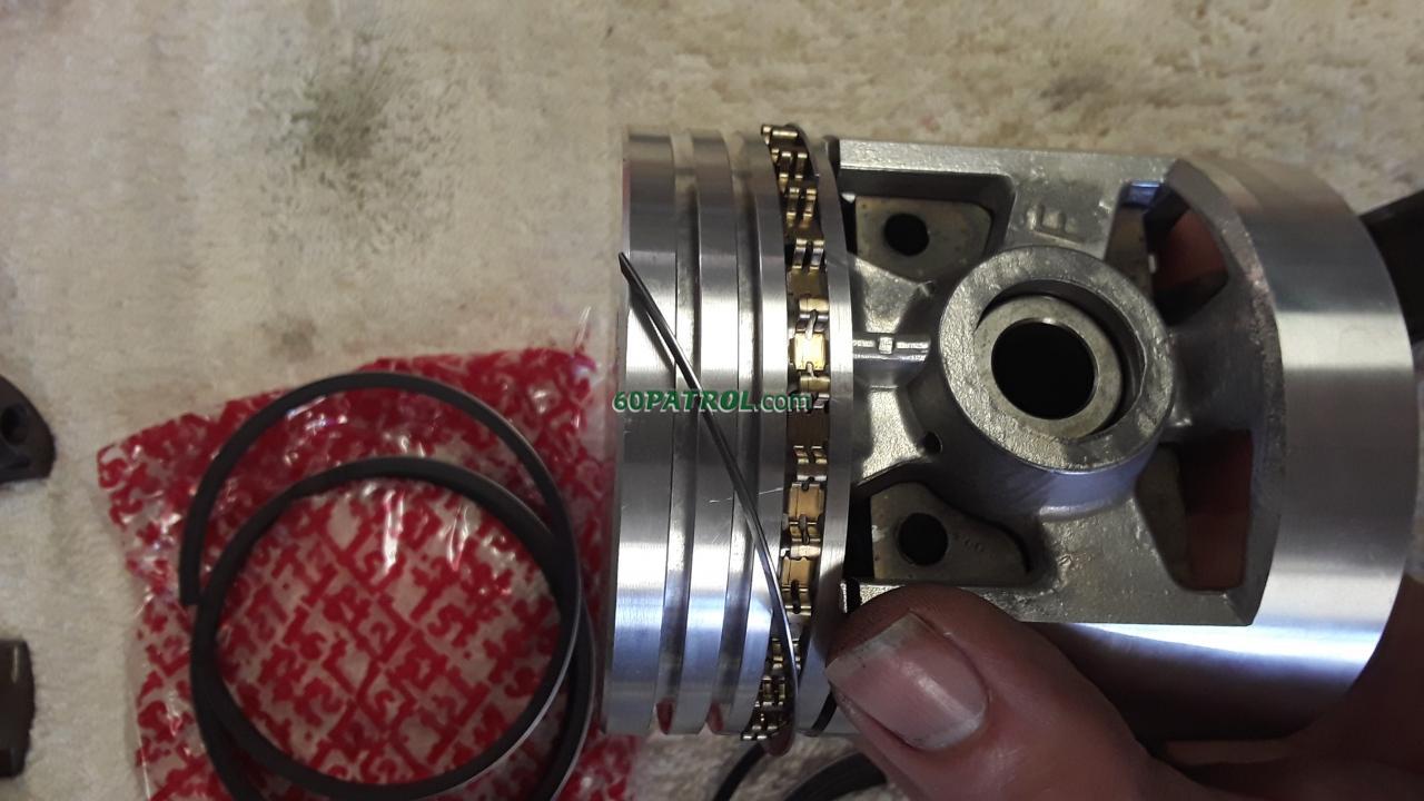

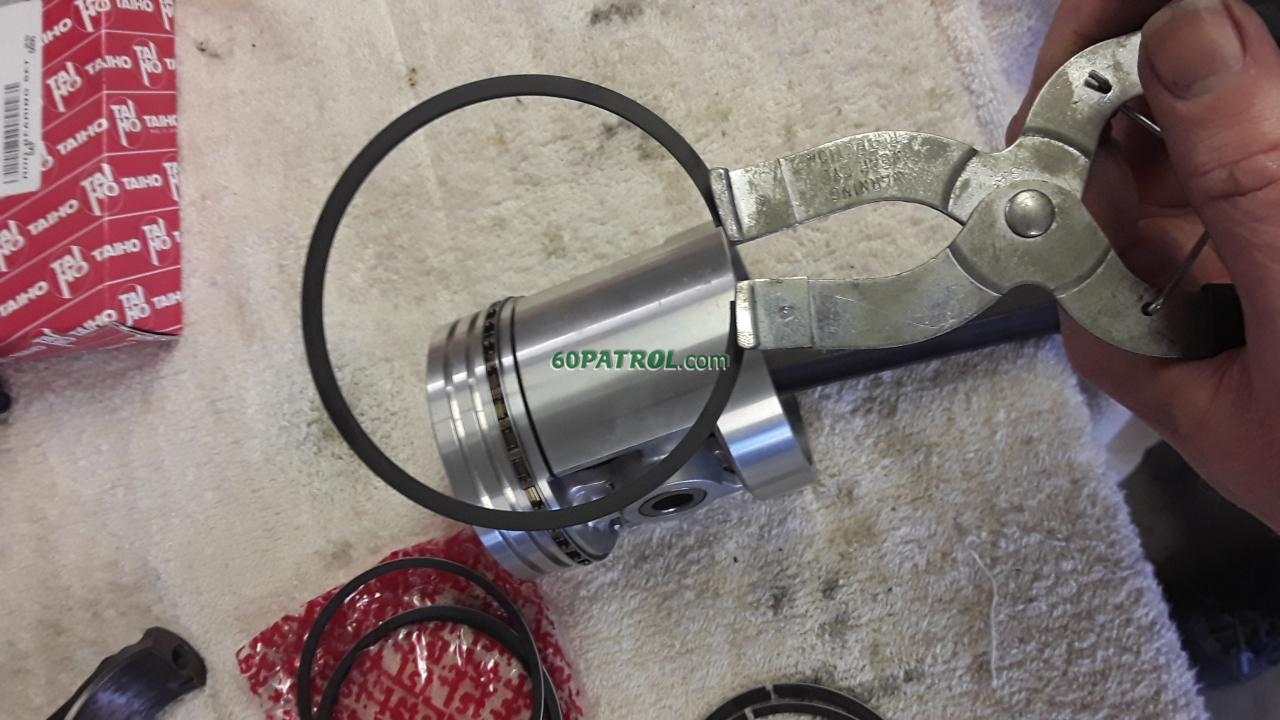

The compression rings usually have a mark that identifies which side is the top. At first I did not think these rings had that mark but I finally noticed the little 100 size on them. only the 1st and 2nd compression rings have that mark. The oil ring has two thin scraper rings that go one each side of the oil ring.
6948
6936
6939
6940
6942
6943
Then I used my ring compressor and then tapped the pistons in with the wood handle of a hammer.
6945
6944
And then torqued the rod cap nuts.
6946
