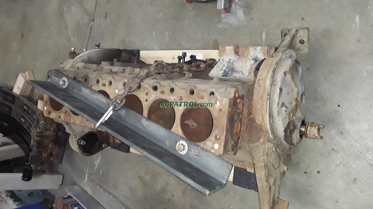

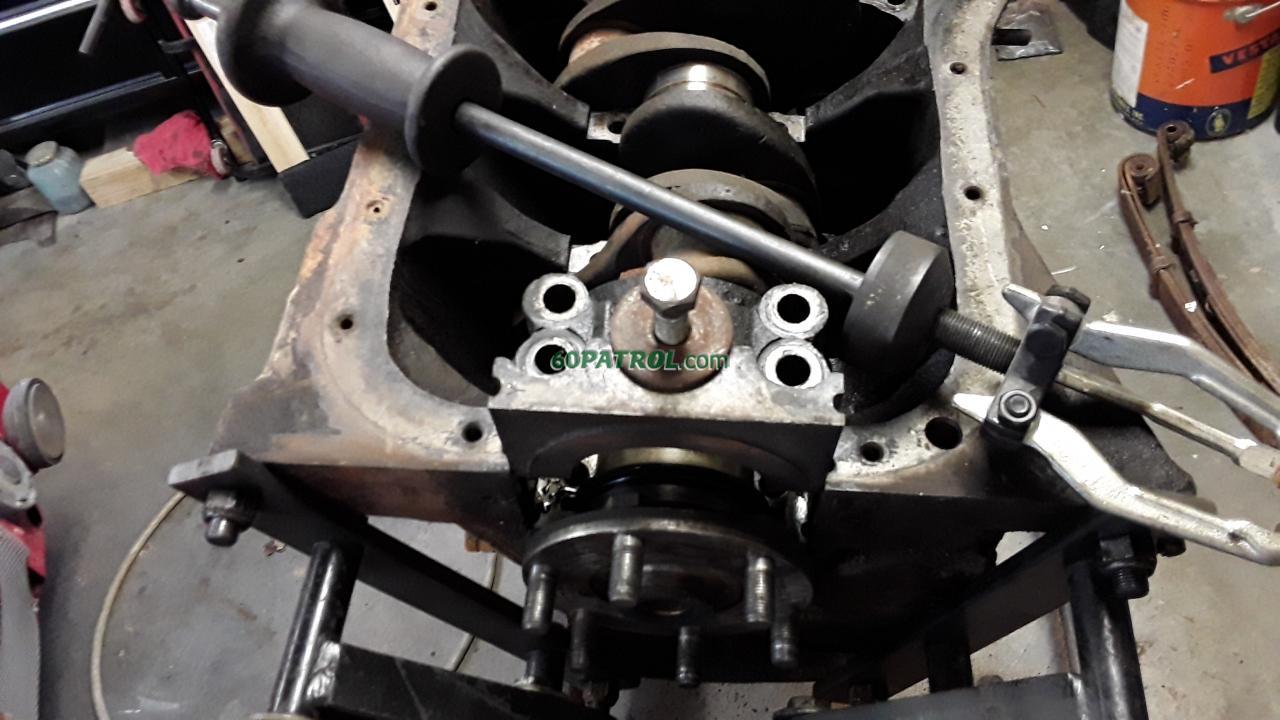

I was hoping to just re-ring the replacement engine that I bought but it has too much cylinder wear and will need to be bored. I guess since there is some boring planned maybe I should go back and see if the original engine is buildable. When I bought the truck in 2017 the head and pistons were removed maybe 15-20 years ago.
5549
Pulling out the lifters and cam I noticed they were in pretty good condition. The rod journals and cylinder walls have surface rust but I think they should clean up okay. I am not sure why they took it apart though. The head was missing but all the valve train and pistons were loose in the rear. I did notice that when pulling out the rear main cap the seals on the sides were missing.
