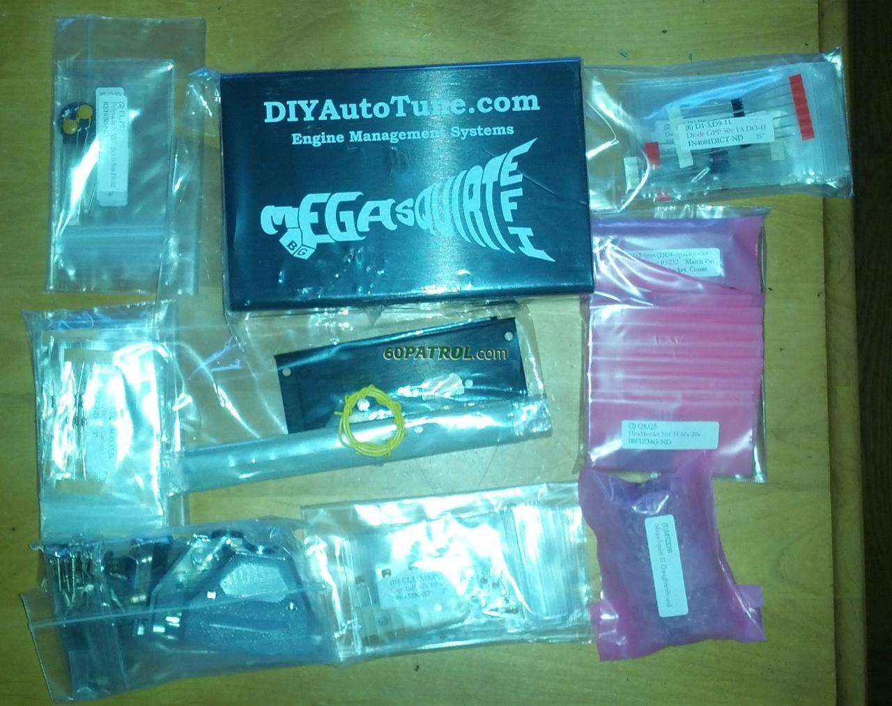

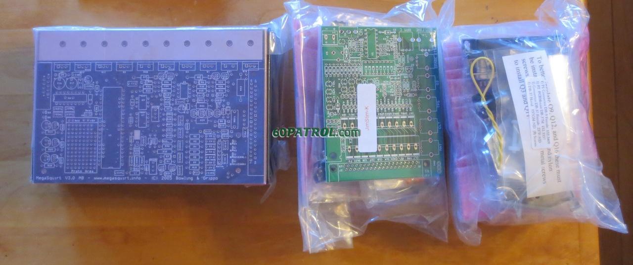

Guess what showed up at the front door? A fuel injection kit, that's what!
Jay opens up the box-o-goodies!
3663
The enclosure, the controller kit and the simulator kit
3664
The simulator kit -- parts on display!
3665
The controller kit parts on display!
3666
Lots of little pieces to put together! I love this stuff! I think that we're off to the races!
