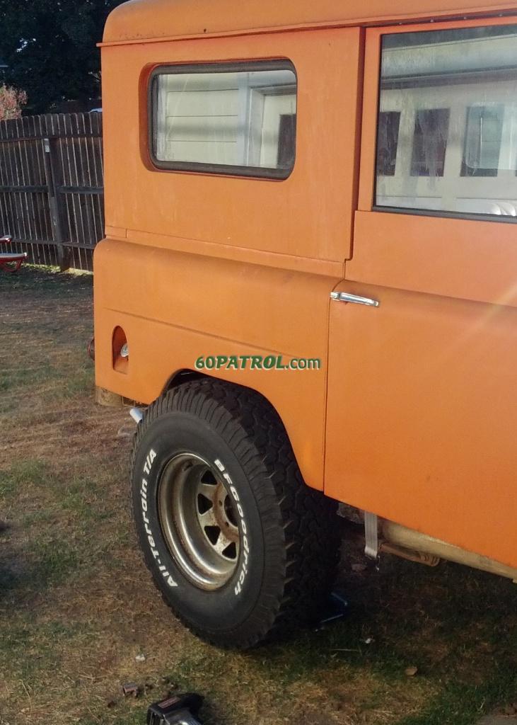

I decided to to a little testing this morning -- I pulled the spare off the '67 soft top and gave it a test-fit on the orange '67. The tire is a 33x10 in perfect condition. Probably less than 30-miles on them. Perfect condition... except that these particular tires are somewhere around 1500 years old. Anyway, it looks pretty good on the front. Not as much clearance as I think should be there -- it could rub on big bumps.
3658
Now for the back... Same tire. Uh, um, nope. It's sitting about 1/2" from hitting the fender... and it's still 1-1/2" BELOW the wheel studs! There is no way this tire will even go onto the rear for a test-fit!
3657
Wanna know why? Because the Patrol rides on the flattest rear leaf springs EVER!
3659
Odd -- The orange patrol has five leaves in back while the soft top has six. Anyway, looks like I need to come up with a leaf spring solution for this beast!
Happy Saturday!
