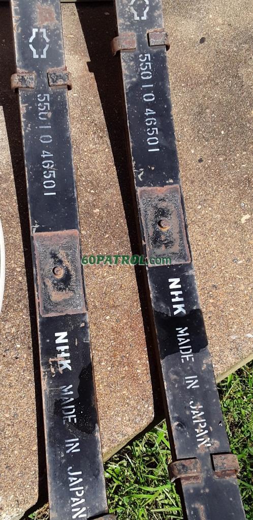

Re: my 1967 patina project build
Post by rdarnell »
Started back working on taking pieces off the Patrol. Got the motor and rear axle out and found some new-ish leaf springs. Not sure what the part number goes back to but is was not the same number as my parts catalog.
Post by Esteban »
Nice surprise about the springs!! :clap: :clap: :clap:

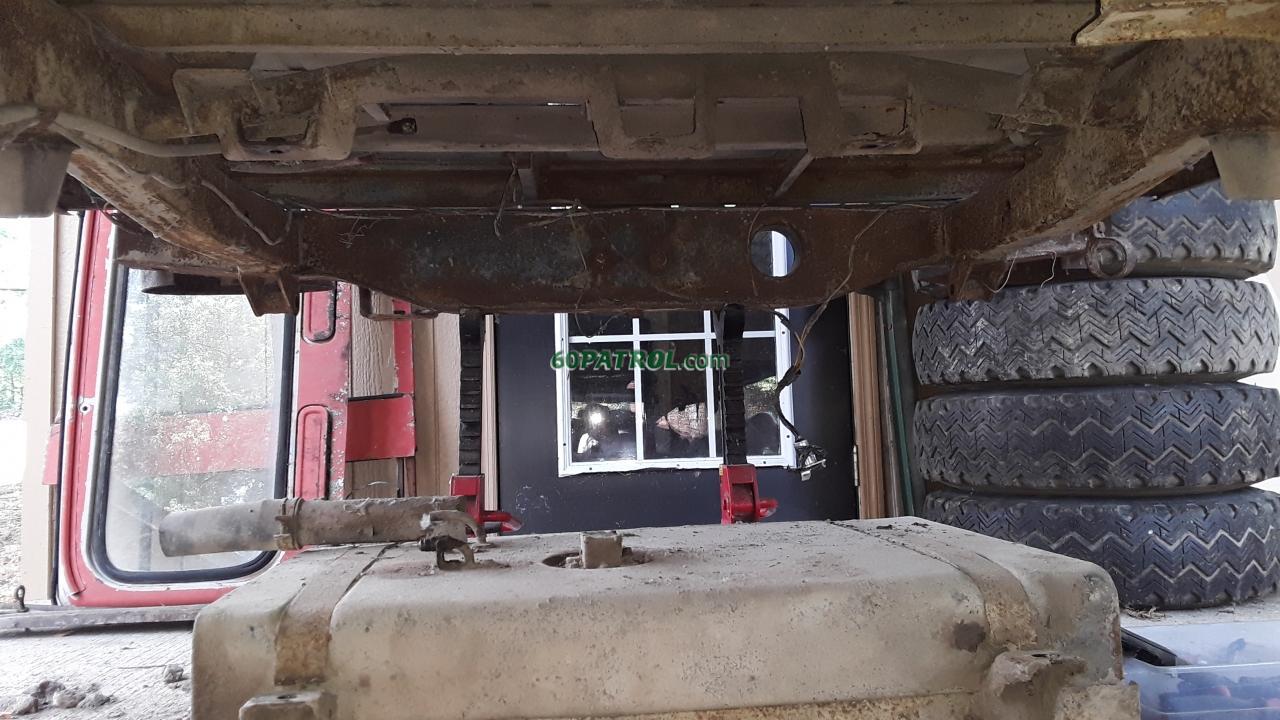

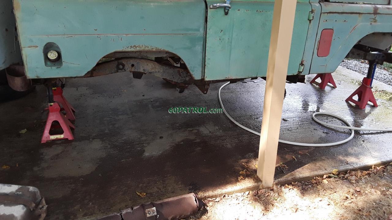

Post by rdarnell »
Took out gas tank and washed out a bunch of 30+ year old Colorado dirt to get ready to clean up underside a bit.

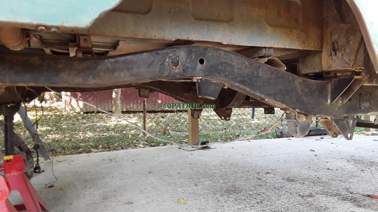

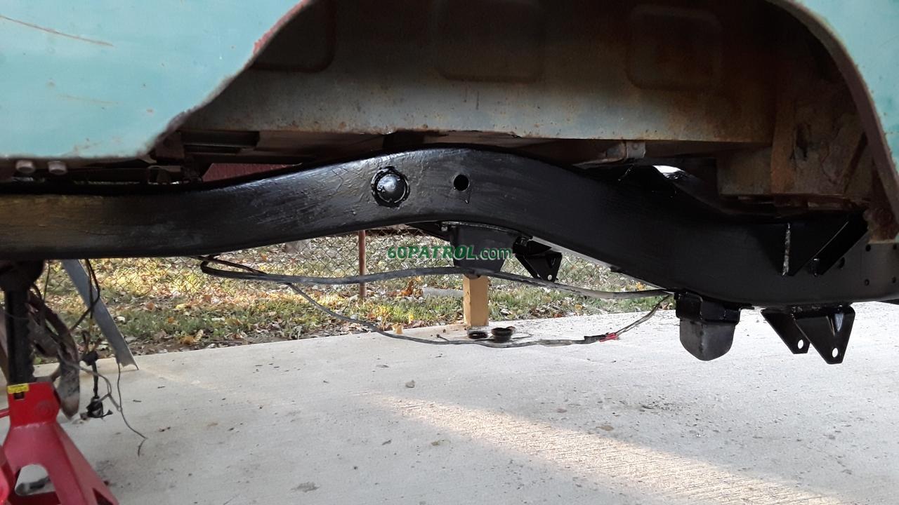

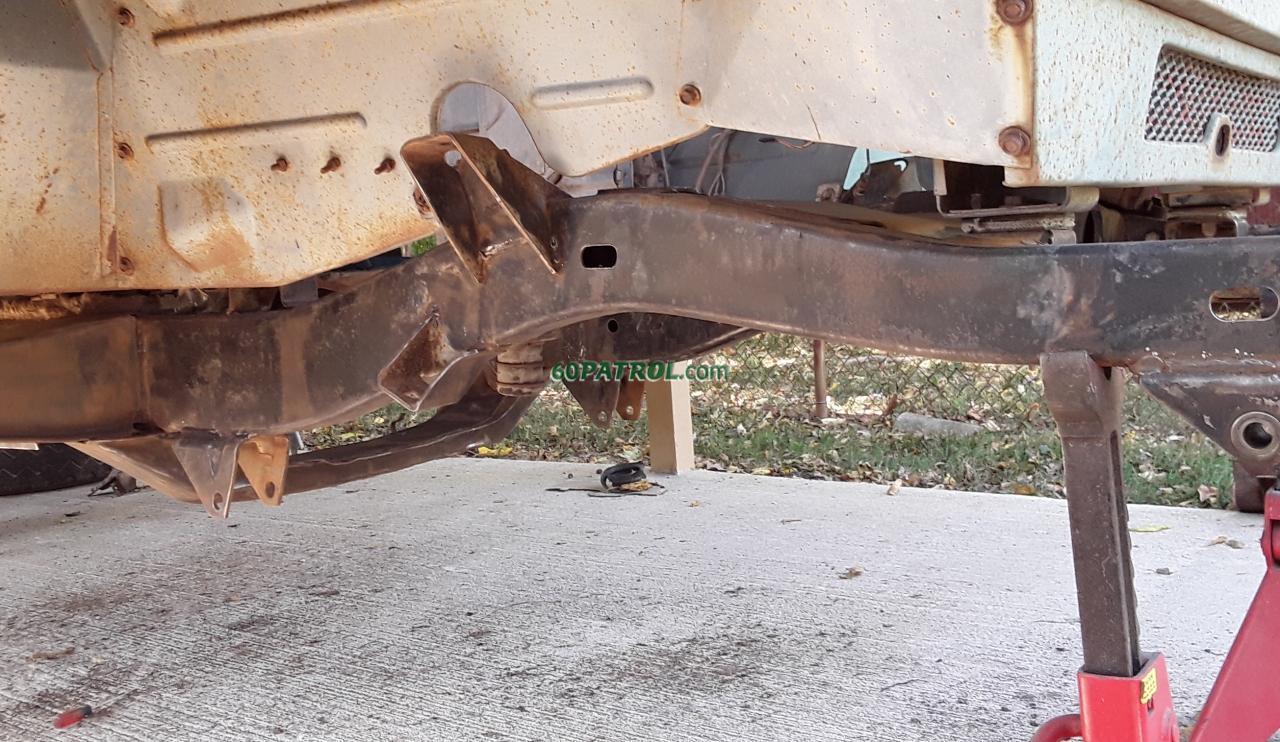

Post by rdarnell »
Used a wire wheel and brush to clean up the frame. Painted it with Chassis Saver satin black paint.

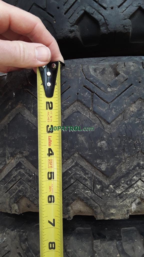

Ordered some tires but I think it was a swing and a miss! The old tires have a 6.75 treadwidth and cross section of 8.75. The 7.00-15's I ordered are only 5 inches across the tread pattern!

rdarnell wrote:Ordered some tires but I think it was a swing and a miss! The old tires have a 6.75 treadwidth and cross section of 8.75. The 7.00-15's I ordered are only 5 inches across the tread pattern!
You're measuring on worn tires and that will increase somehow the treadwidth. Probably a better comparison will be to check the nominal specs of both tires. Maybe the difference won't be that much.
