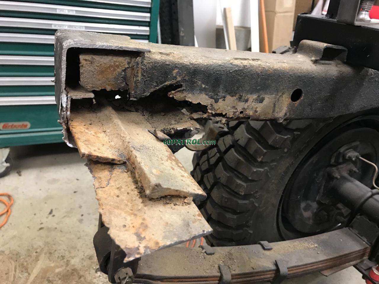

did a little more work on the rear cross member today. We dropped the fuel tank and cut out the majority of the old rusty crossmember. I'm so glad we did this because it revealed a ticking time bomb. A little more rust, or a hard pot hole hit and the rear shackles would have come detached from the frame.
From the outside, doesn't look too too bad.
With the center of the rear cross member removed - the terror is revealed. Looks like somewhere along the line a bunch of scrap metal was just jammed up in there with a lot of weld and they called it a day.
With the angle iron along the frame removed, you can see the rust hole that they were attempting to patch.
Right underneath that rust hole is the shackle mount! I am going to have to remove the rear shackle mounts, patch and reinforce the frame and then re-attach the shackle mounts. The good news is that it looks like the rust is confined to the very end of the frame. I am so so glad that I cut off that metal hard top that was welded on. There was a lot of rust at the extreme rear of the vehicle that I suspect was caused by that hard top. Because it was welded on, there was no other way that the rear tub could have been removed to address this issue.
