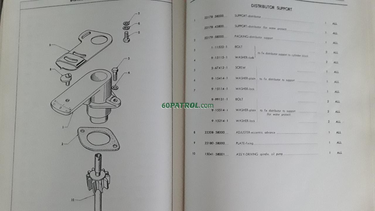

Re: How-to: Convert to Pertronix electronic ignition
Looks like there are 2 different distributor bases according to my 1965 parts catalog. Part Number 22178-58100 looks to be the base for the Hitachi D608-51 and part number 22178-43800 would be the correct base for the Hitachi D608-02 water protect distributor. From earlier posts it would appear the most US Patrols came with the water protect style of distributor.

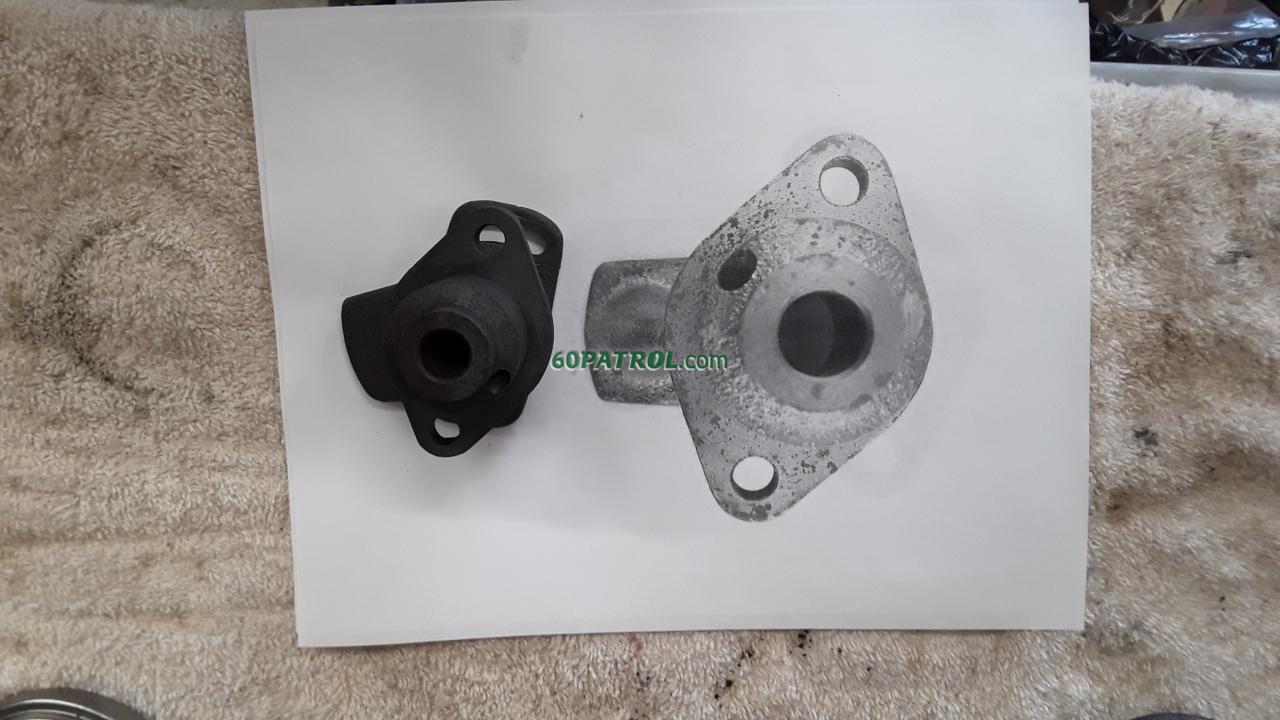

I was able to find and print out a picture of the 22178-58100 and compare it to my distributor base. The picture is not to scale but for appearance only. Placing them in about the same pose I see some big differences, mainly in how the distributor is locked down. The water protect model has the pointer mounted to the distributor and 2 locking bolts underneath while the non protected distributor has the pointer attached to a separate piece and uses an eccentric advance bolt on the top side.
In addition I looked at the timing marks in respect to the mounting holes to the block. The center on the water protect style is at about 110 degrees and the other is at 100 degrees which would support that 10 degree adjustment problem when using the later C7000 distributor in the water protect mount. I am also kind of suspecting that there might not be much difference in the mounting of the C0601 and C7000 distributors.
