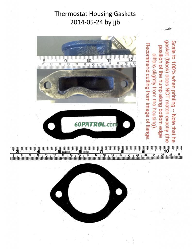

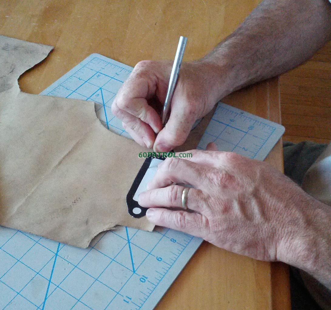

Actually got to work on the Patrol a bit today... Assembled the thermostat housing and got the water pump prepped. Discovered that despite having two full gasket sets and several misc gaskets, I one had have a thermostat housing gasket... and it was damaged! Suddenly, a light went on... I'll cut my own!
Here's the task
Here's my first attempt...
So, this gave me a great idea... I'm going to scan and save scaled images of each gasket as I install it so in the event I have to do this again (and the second engine is currently at the machine shop being rebuilt
Anyway, here are the first few... for future reference!
Have fun!
John
Here's the task
Have fun!
John

Re: 1967 Family Patrol Project
Dude.... SERIOUSLY ?!?!?!?!
These are AMAZING. But, I find it just a little bit disturbing that you had time to put that much detail into it...
Ummm - could you please hurry up and tear down your tranny and transfer case, and make up some templates for those gaskets as well?
That MIGHT just get you off the hook with the Odometer-Police
