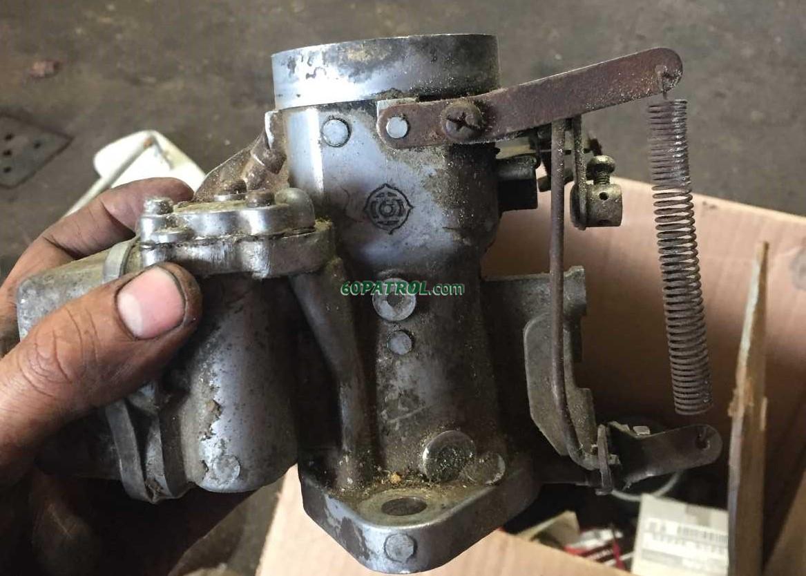

i have two carbs currently and wanted the boards opinion on what they are.
Carb one that was in a box of parts with the Patrol:
5666
Carb two that was running, but leaking a little:

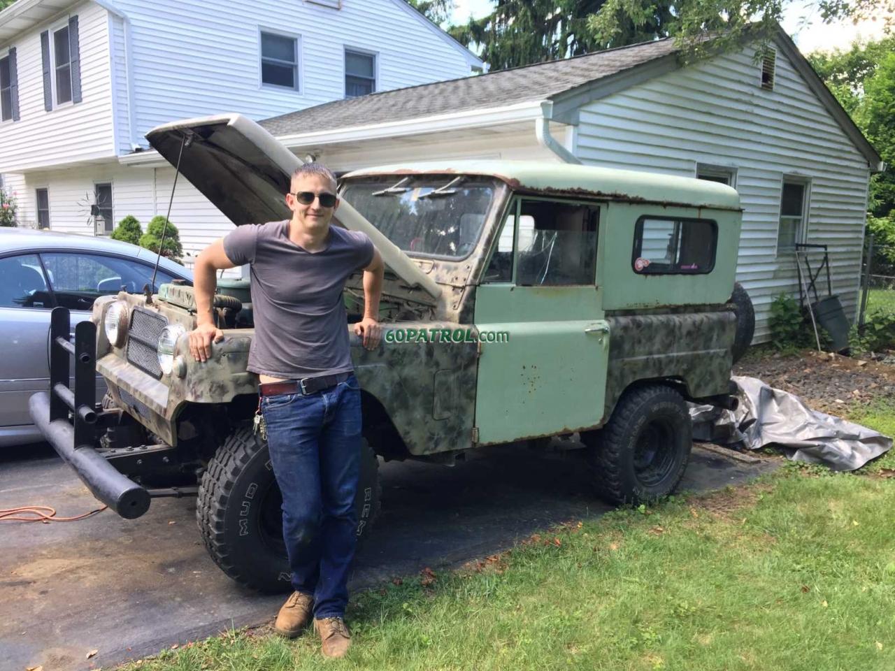

Now that I can upload pictures here is one of me with my Patrol when I picked her up:
5664
I am still confused on year. I have the later model steering wheel, but I have the regular circle style lights.

KyleAnschuetz wrote:...I have two carbs currently and wanted the boards opinion on what they are.

The first one is the original Hitachi carb. The Hitachi logo is showing there. It is a so so carburetor at best. Extremely simple. The accelerator pump is driven by a plastic cam that is on the outside. This cam wears often and the carb develops a flat spot. It might be difficult to source a spare cam, but making a metal one could be done with lots of patience. This carb has plenty of high end power, but nothing else. Fuel economy is not great also. For years I had a 74 with that same carb. I still might have a couple of components, but no gaskets. Let me check. Regarding parts, repair kits are probably available in Colombia and Australia, although the Aussie one might have some differences because of antipollution components.
The other carb is a Carter, but not sure about the model. I've been running a Carter YF 1-V carburetor on mine for over 15 years, and I think it works very smoothly, and best of all, you've have plenty of parts available. Mine came from a 1980 Bronco with a 6 cyl inline 300 cid. I only changed the automatic choke for a manual one. You can probably source a repair kit for your Carter.
