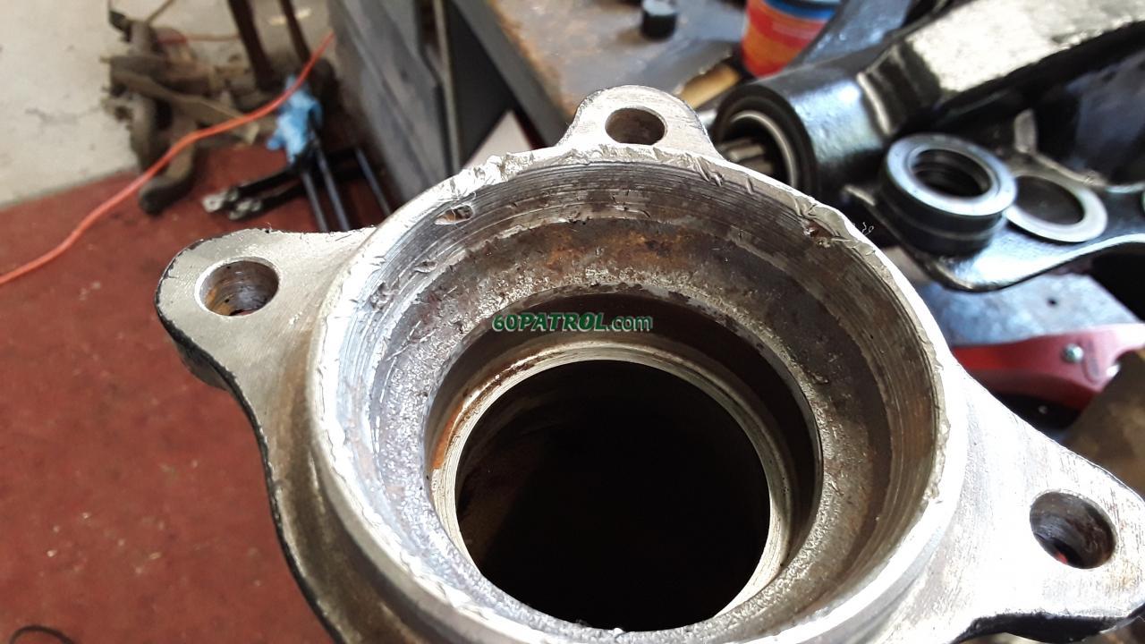

last weekend I got the real axle mostly assembled. Installed the correct double lip pinion seal in bot axles ( I ordered them on the Amayama site, the are UD parts but the same).
I made mention previously that the short axle had been replaced sometime in the past and here you can see some prior carnage from what looks like a broken axle shaft.
I got all the new inner axle seals in and both sets looked the same, I went ahead and put in the ones that had the Toyota part number from Lazorlite and put the Timken seals in my spare parts box. Cleaned up all the shims and reinstalled the axle shafts. i still need to paint the ends but I decided to clean up all the other suspension parts and do my painting at one time.

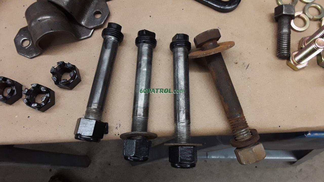

Got rear axle installed yesterday. The rear springs had been replaced some time in the past and the part number translates to a 1974-1979 Nissan Patrol.
Replaced the sway bar drop links and bushings. The drop links are from Prothane #19-419-BL they are 7-3/8 inch long. the polyurethane bushings were a little too thick so I removed about a 1/16" from each on my bench grinder, prepare for a mess. I used Energy Suspension #9.5124G 20mm bushing kits for the frame mount of the sway bar. I also installed KYB Excel #343219 shocks.
got the rear back on the ground, before any jack stand fatigue set in, with the Super Swampers on FJ40 rims. I still need to build a rear disc setup, but that is for a later date.
I also noticed a little damage to the rear wheel arch from when that rear axle shaft broke sometime in the past. Not sure if the springs were replaced at the same time but one of the fronts was a later style spring also.
I also have some repairs to make on the front leaf spring mount before I can install front axle. Apparently the original pin was replaced in the past with a bolt. This was also the same side on the front that had one of the springs replaced. Maybe they had to cut the old pin out and went with a bolt as a replacement when they replaced the spring??? who knows. Also on a side note the original pin bolt is actually a metric thread, the shackle end is standard much like all the other bolts. The grease zirks are also 10mm hex head.

Nissan/Datsun predominately used zinc plating (either clear of yellow). There is some discussion on classiczcars.com if the brake lines where cadmium plated, however nobody has come forward with lab analysis results.
