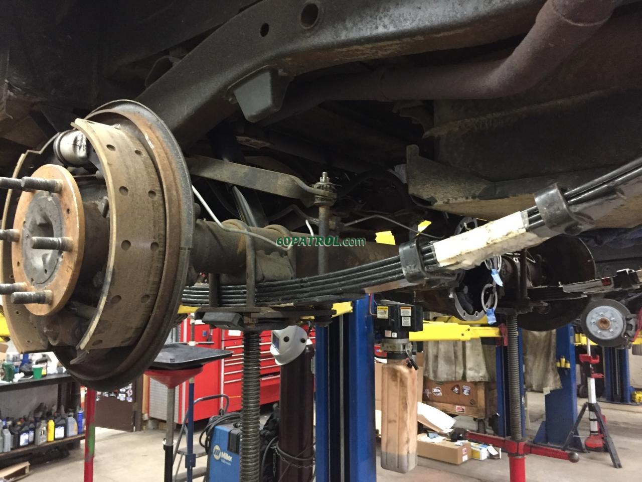

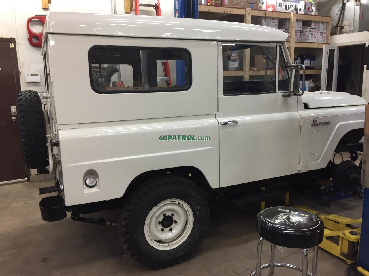

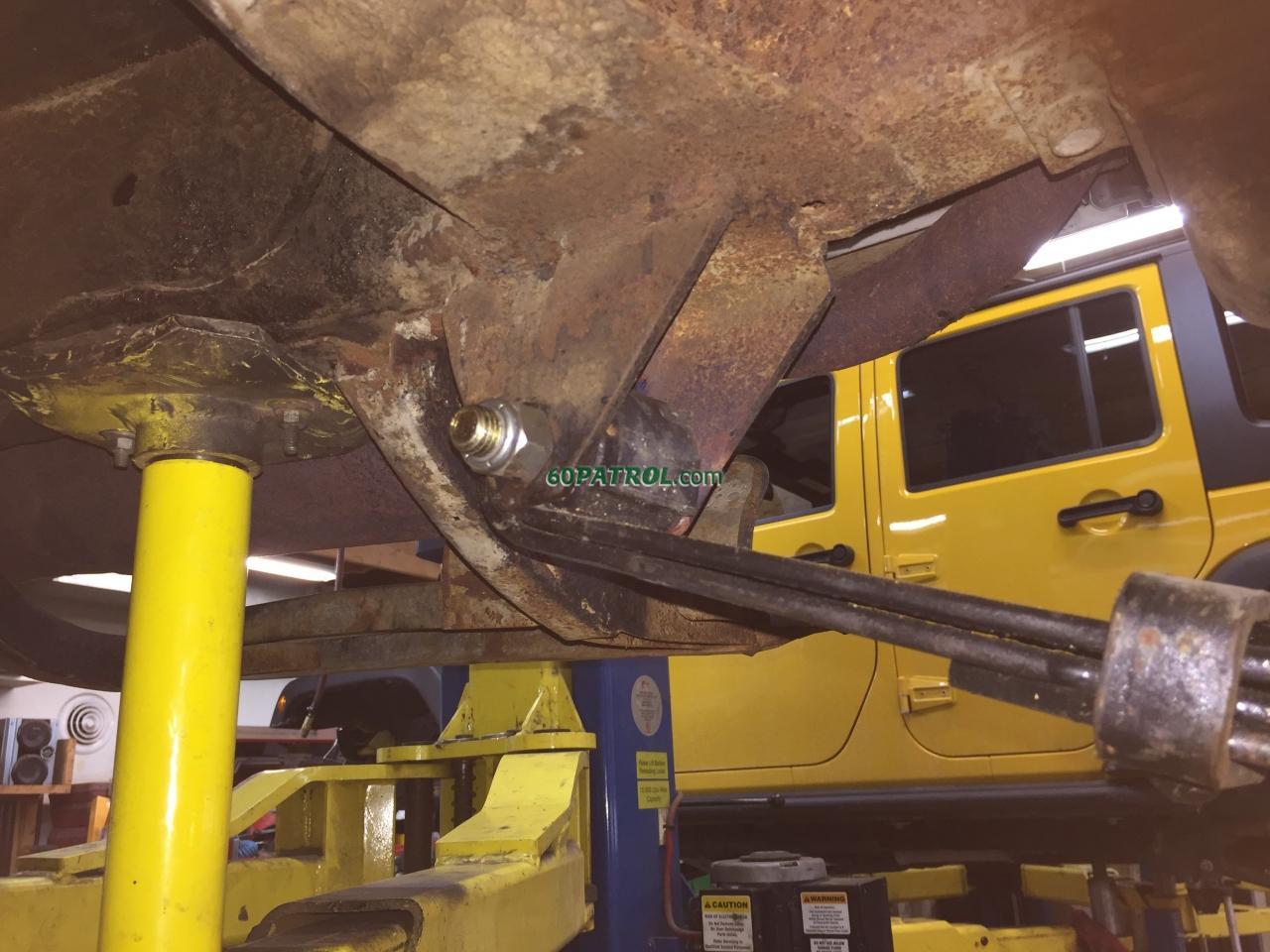

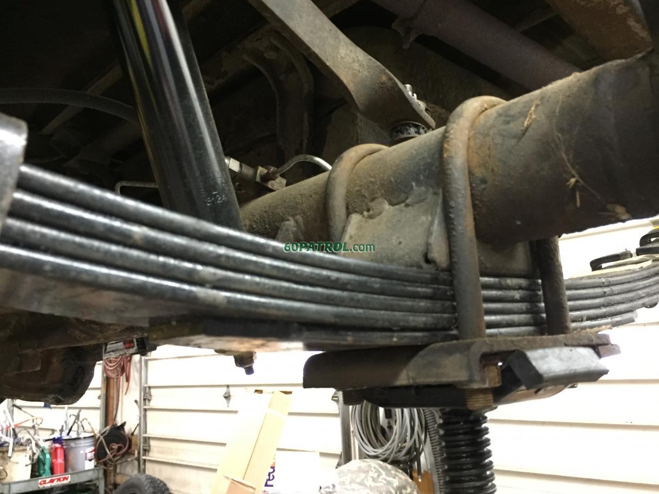

I know I'm slow but I finally installed the Alcan standard lift replacement springs. You can read my earlier posts in this thread. I bought a 16mm reamer and that did the trick. all bolts are 5/8in. The Specter shackles worked fine. I was able to reuse the original u bolts. I will send additional picts when on ground and an assessment of driving characteristics.

Excellent pictures with very good details. Thanks for posting them. They will become a definite reference for other members.

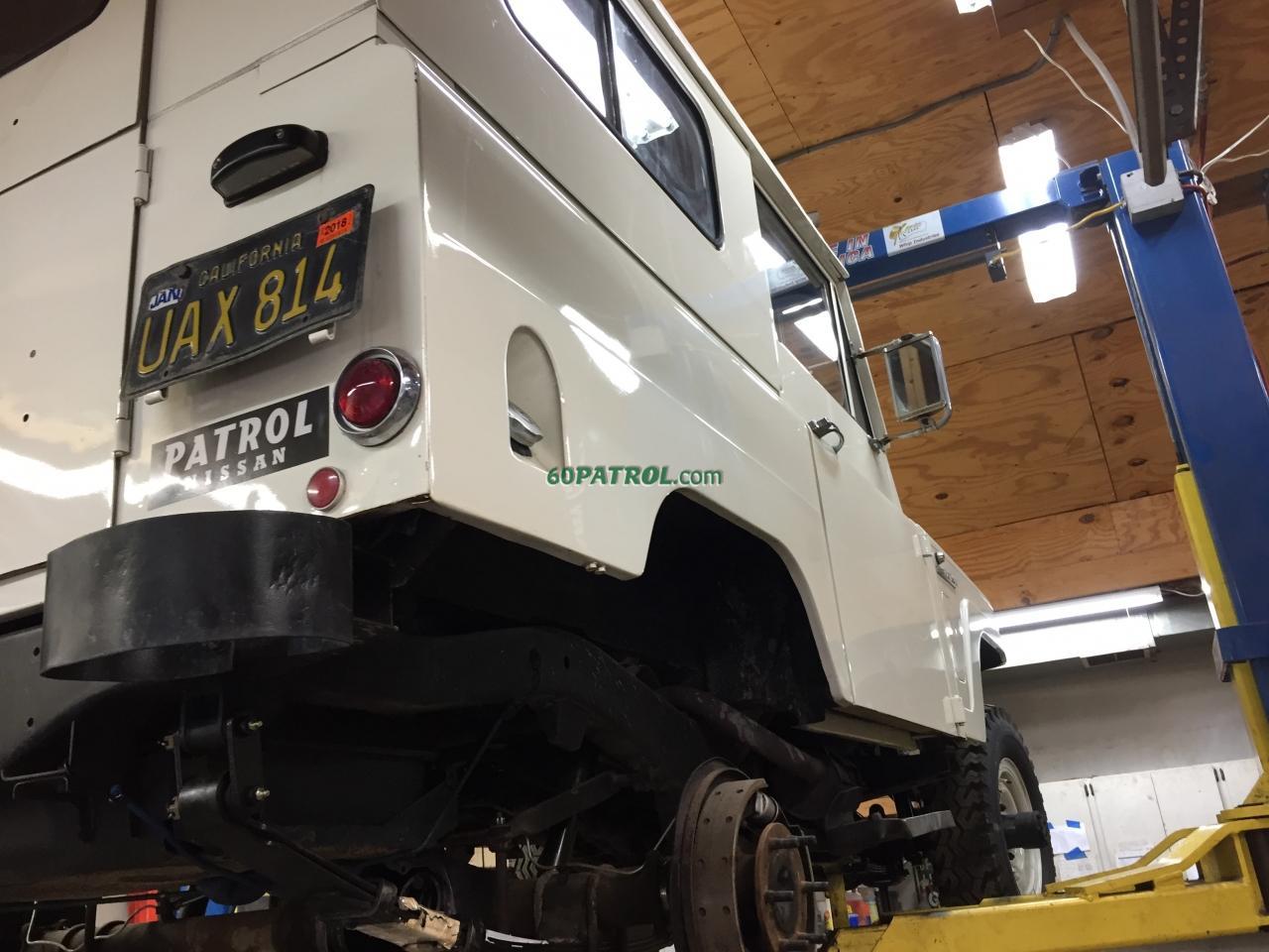

5777
rear ride height with Alcans
So the Alcan springs raised the ride height. Front is jacked up while working on steering. Because of the raised ride, the steering center has moved such that I drive down the road with wheel approx 90 deg to where it was.
question to y'all is do I pull the steering wheel and realign on the splines to the 12 oclock position, or is there another adjustment (I dont see one)
Thanks

Toads Patrol wrote:So the Alcan springs raised the ride height. Front is jacked up while working on steering. Because of the raised ride, the steering center has moved such that I drive down the road with wheel approx 90 deg to where it was.
Thanks
I don't see any other as well. Very interesting what you mention about the shift of position of the steering wheel. This will help other membes avoiding scratching their head trying to look for an explanation. Probably the shim that you added to the springs for the pitman arm attachment also contributed a tiny bit to compound this.
