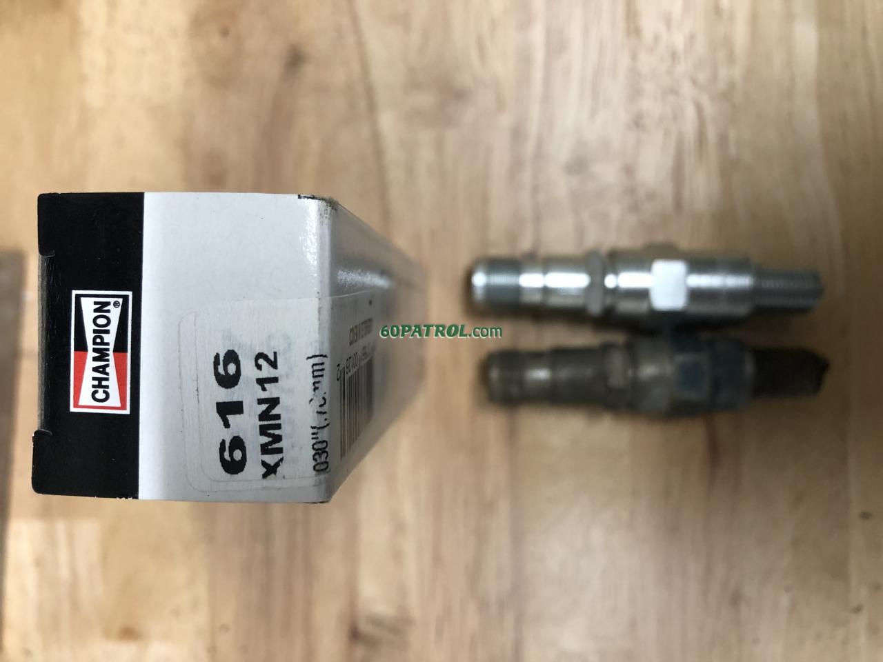

Side by side comparison:
6083
6082
I am still using the "original " plugs that were on the Patrol when I purchased it.

Zed, can you post a photo of the spark plug end of the spark plug wire? As detailed as possible. We are going to try to make the Champions work. Thank you.

Thank you Zed, I can see Plateaucal's wheels spinning now.

Awesome. They look a little different than the ones for other vehicles. The large "boot" above the nut is different than that for a Pinz., Unimog or such. But we will figger it out. Thank you.

Sorry to dredge up this old thread..............but has anyone actually used the Champion 616 plugs on their Patrol? What I'm interested in knowing is did the original spark plug wires connect up to the Champion 616 plug correctly? Thanks for any input on this.

r1lark wrote:Sorry to dredge up this old thread..............but has anyone actually used the Champion 616 plugs on their Patrol? What I'm interested in knowing is did the original spark plug wires connect up to the Champion 616 plug correctly? Thanks for any input on this.
(I did look at all the threads related to waterproof spark plugs but could not find the answer to this question.)
Yes. They work perfect. They are the Champion interchange for the original NGK. Also Autolite/Motorcraft AGR3S, Bosch WC175ERT, WC7D , WC8D.
