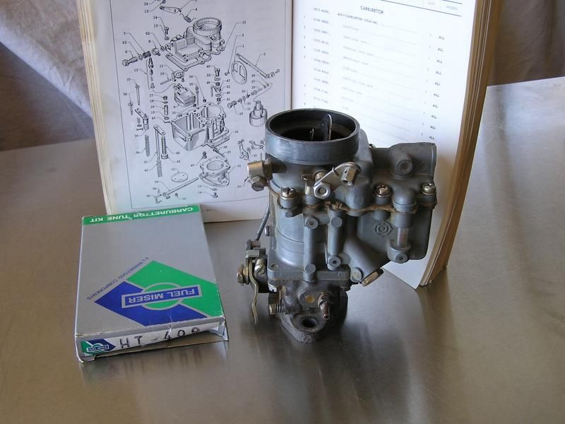

RiverPatrol wrote: The FuelMiser HT409 sounds correct for the VC42; I'm pretty sure those are the kits I have. I'm sure I could Google some warehouses there, or use the same one I got the VC42 kits from. Thanks for digging up the kit number. :happy-bouncyblue: :handgestures-thumbupleft:
Yeah, HT409. I did not notice the # till I looked at the kit I have too. My wifes uncle who has lived in Colombia for decades is buying us a rebuilt VC42, two more kits and a few other parts from ColOOOOOOOOOOO:lol:OOOOOOOOOOOOOOOOmbia. :clap: :clap: :clap:
If it does not turn out a PITA I'd like to get some other items too. I'll let you all know if it turns out.
This carb is really fun to have and it does run well and seems the best design to me......oh, and it is an original.

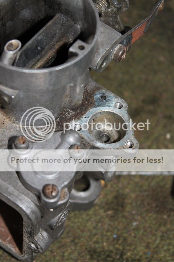

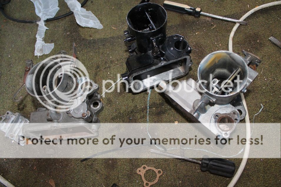

Hi all, Its had me thinking why is my VHA different to every other one I have seen. Its still got me think, but besides where the power valve goes through the top of the bowl, on my VHA there is another type thingy next to it, Attached are some photos of what it looks like, does anyone know why its got this on it ?
Cheers G60mike
none of the spare VHA's i got have this setup :think:
