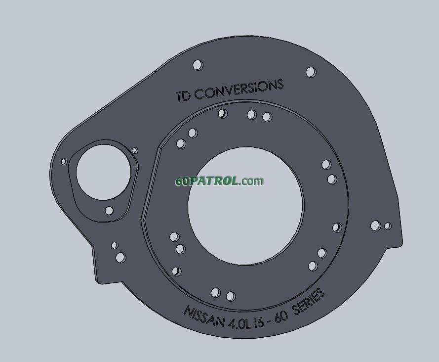

I'm going to start a new thread on this since the old thread started out with the assumption that I would be going the Cummins route for a diesel conversion. However, the more research I did, I realized that the VW TDI engine is a very popular conversion for jeeps, so I figure it should be a really good option for the Patrol. The biggest challenge is that I want to keep all of my running gear the same - transmission, transfer case, axles, so how to mate up the stock G60 transmission with the VW TDI engine? I need an adapter plate of course! But, none exist for the Patrol. I reached out to some folks north of the border in British Columbia. Last year I sent them an engine, fly wheel and bell housing from the stock motor and waited..... and waited.... and waited... But, alas, this week I was sent the CAD drawings for this project. It consists of an adapter plate and a crank housing. These parts are being machined currently and Reid at TD Conversions has said that he will send some pictures of it as it goes through the manufacturing process.

Hello everyone! This is Reid from TD Conversions. The Volkswagen TDI to Patrol adapter kit was completed this summer and is now in the possession of mad4hws. Here are some teaser videos and photos of the adapter kit. Turn up the volume and turn on your smoke filtering glasses.
I will make a dedicated post on all the features of the kit and how it all works and a link to mad4hws' build thread.
