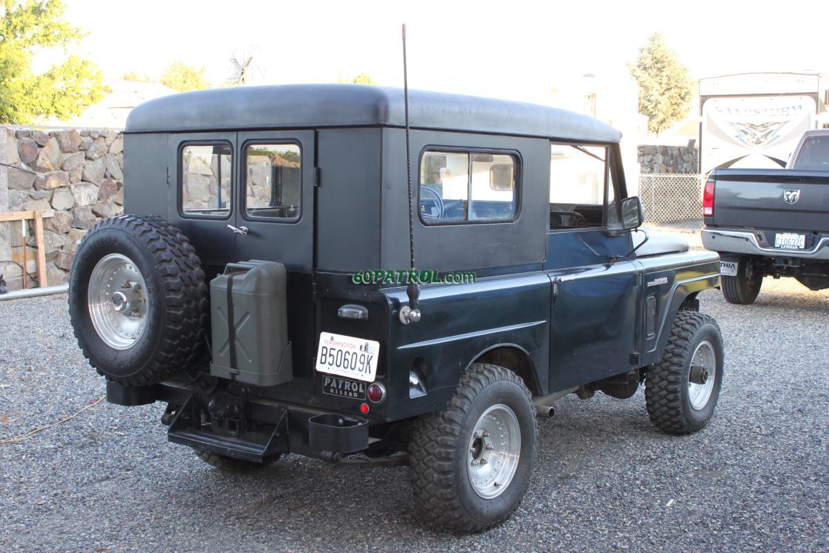

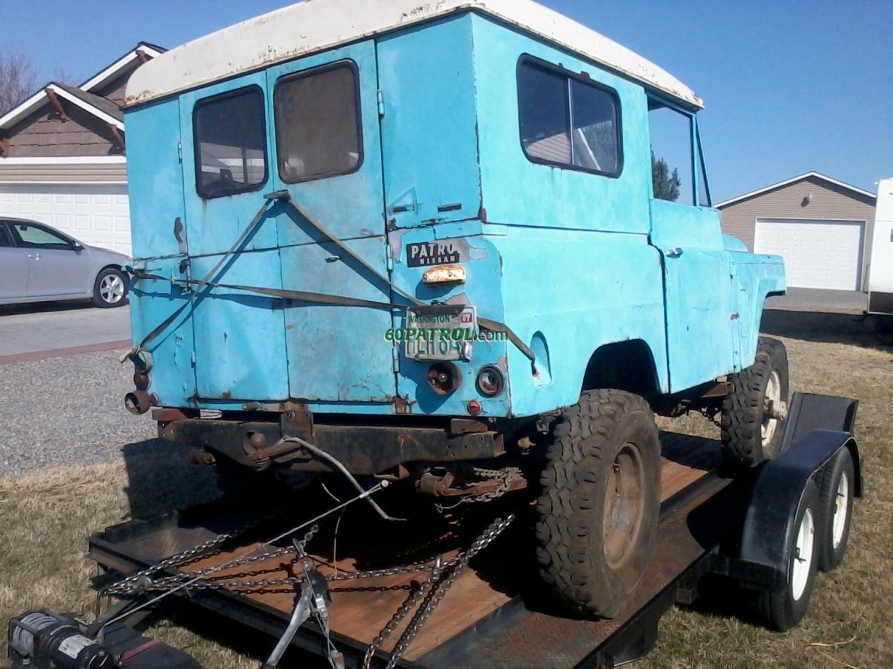

The later roof top sections have rounded corners where as the earlier ones have a sharper edge when going back towards the rear5078
This is my 68-69 . The earlier tops rear section is vertical above the barn doors and the bends over in nearly a 90 degree hard bend.
The tops are interchangeable. 2501276
The blue vehicle shows the sharper rear roof edge.
The red one is a 66 With a 69 roof....

The bolt holes probably won't line up. You'll have to drill new ones.
