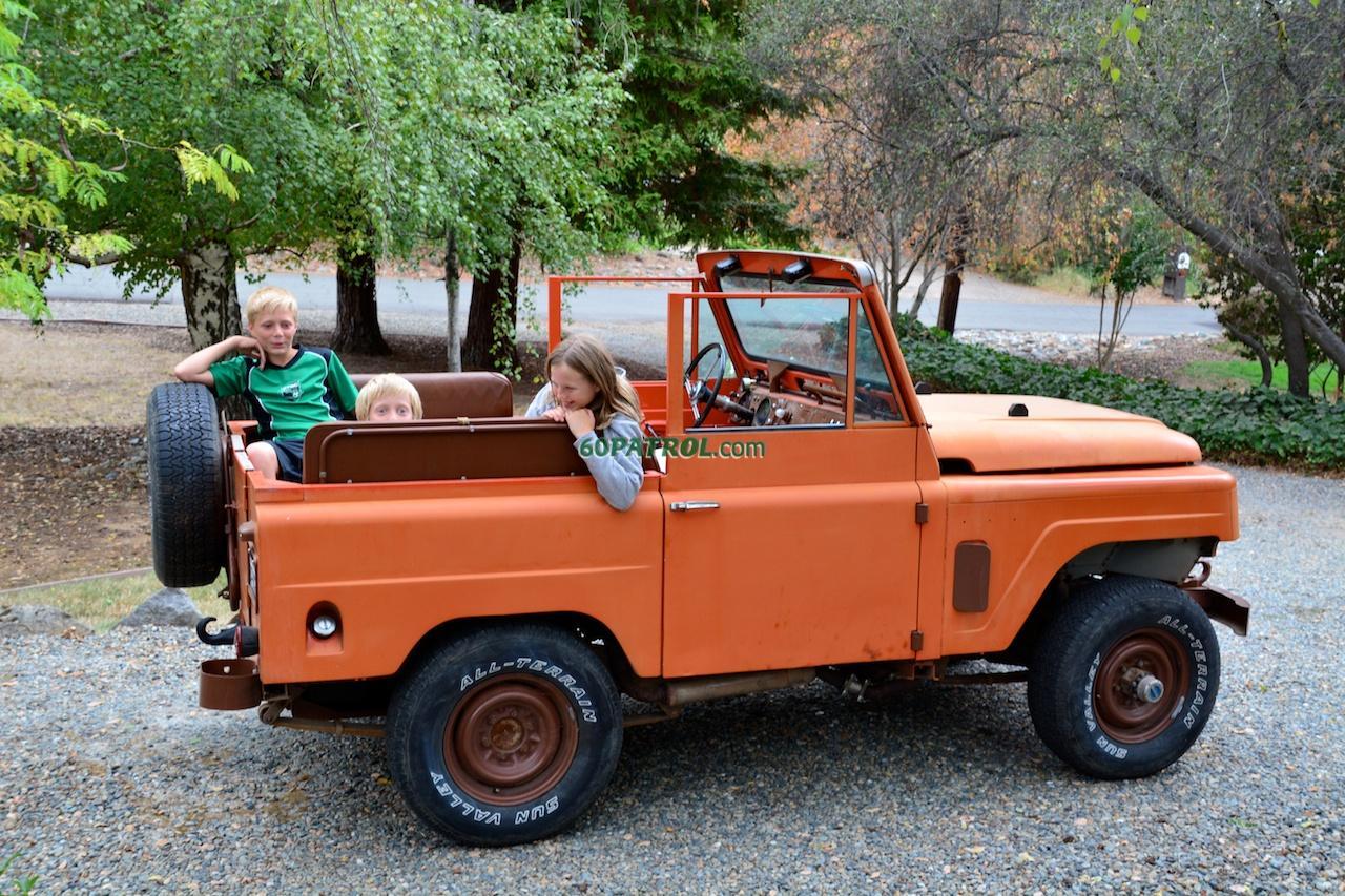

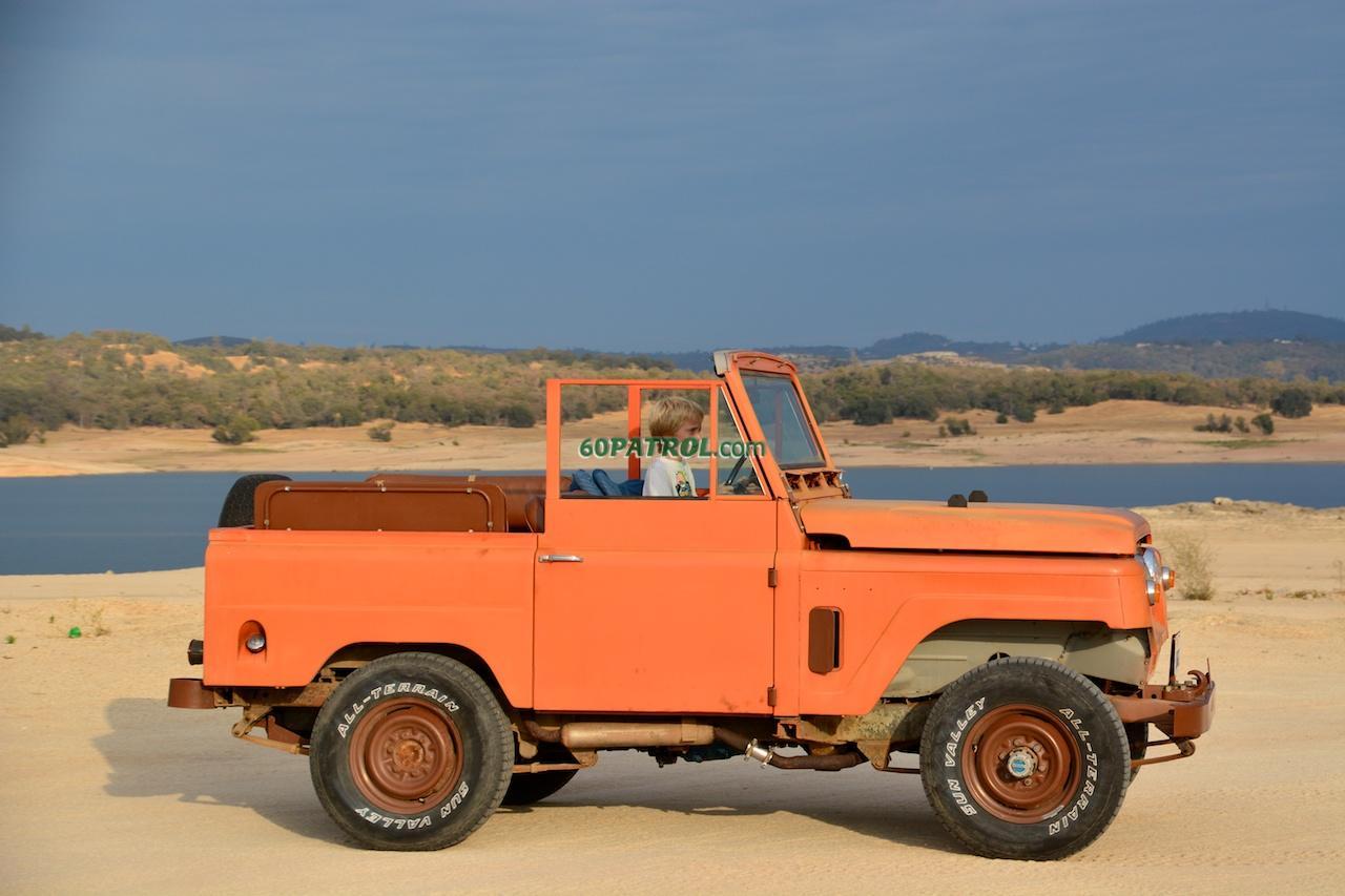

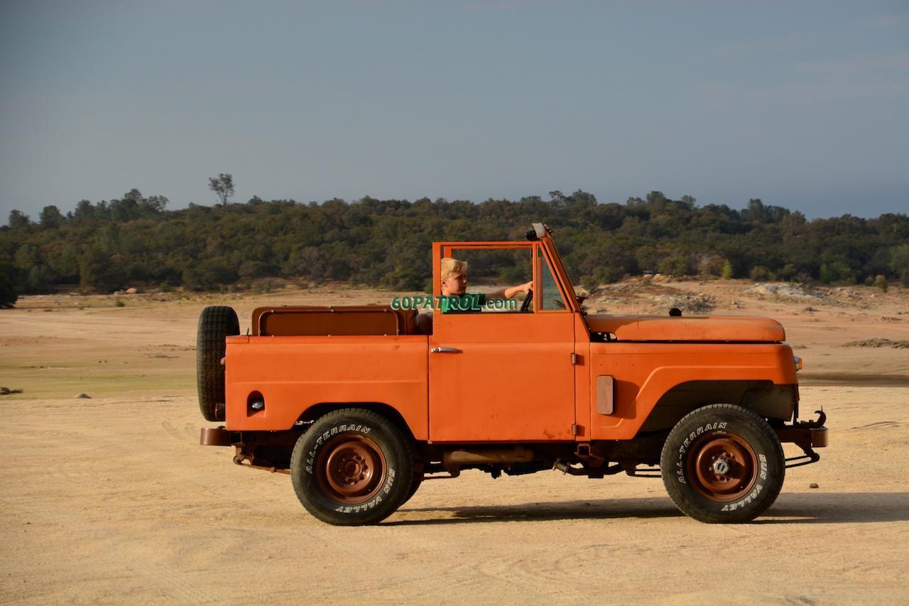

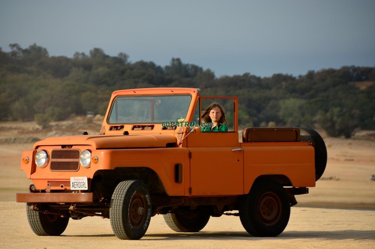

My dad sent these over -- These show THE reason why we got the Patrol!
On our way to the lake, we stopped at my folks house...
Joe takes shows his driving technique
Barritt takes a spin
Jay navigates the terrain
Thanks to all for your advice and help getting this beast running!
