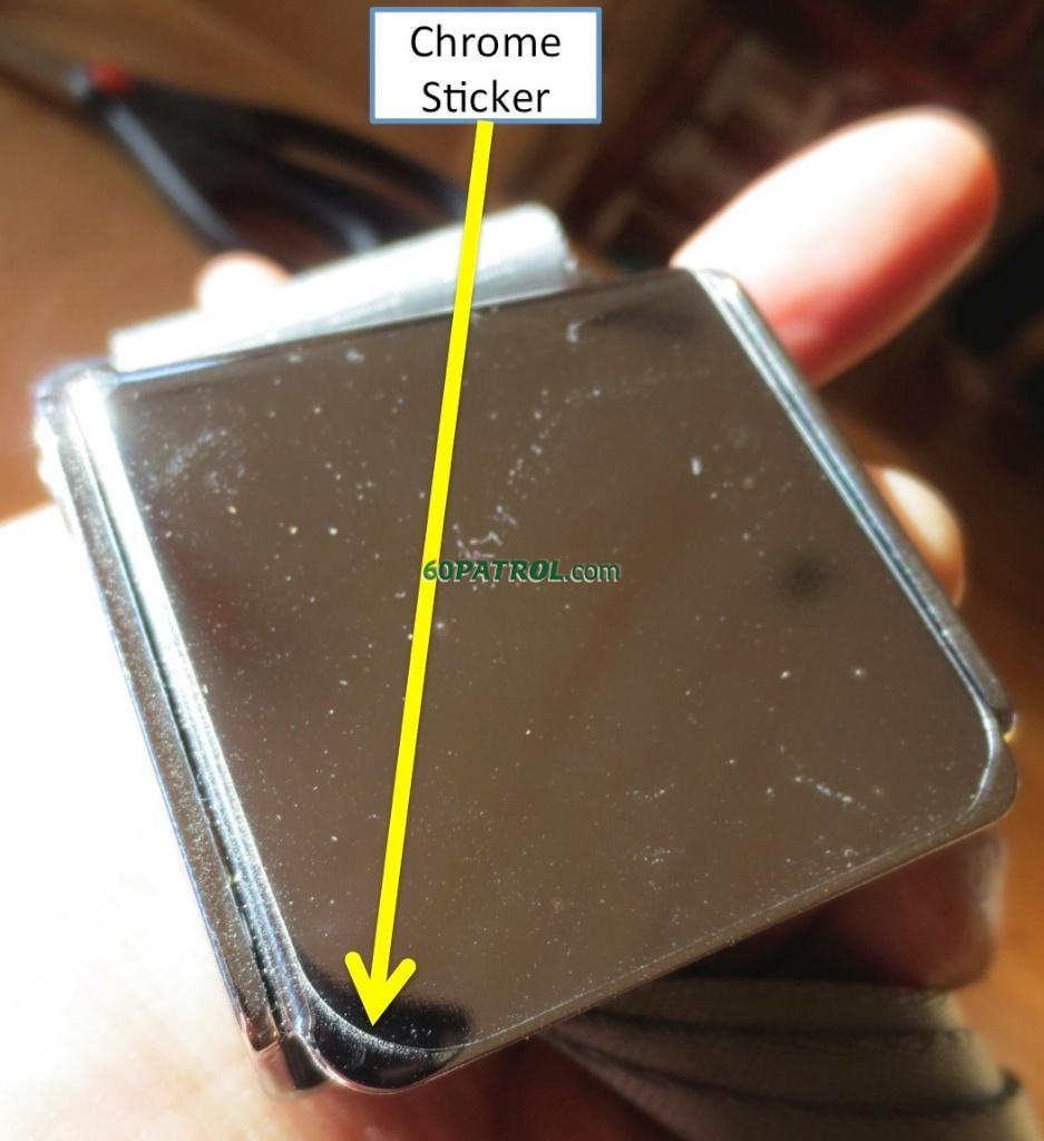

Since we think we're getting close to actually putting the engine back in, I ordered one new seatbelt as a sample to see how it looks and how well it will work in the beast. If it's decent, I'll order six more so we'll be fully equipped for trips to the backwoods. Anyway, it got here yesterday. First, I installed it somewhere safe to test it's effectiveness but discovered that it is too easy to release and does not fully restrain the kids...
Provides safe TV viewing...
BTW, it's Barritt's 11th B-Day today...
Okay, in reality, I'm not thrilled with the belt... It's chrome, but that "chrome" comes from a sticker and the rest of the buckle just appears to have a light zinc coating or similar.
Here's what it cost: Now, we're looking for Plan-B

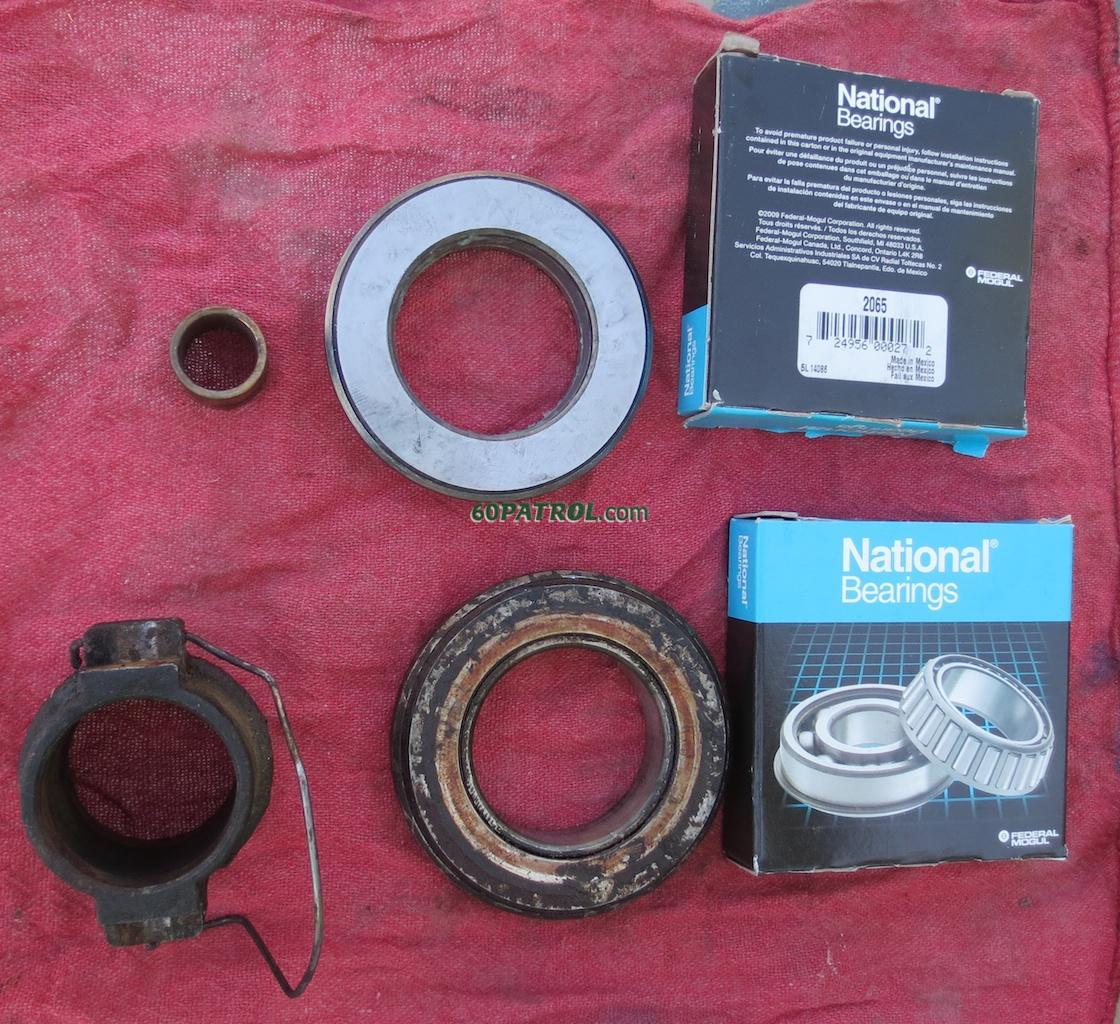

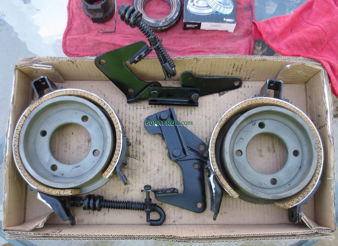

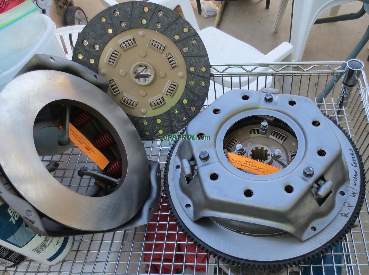

The new clutches are here! The new clutches are here! I AM SOMEBODY!
I got the call today... Capital Clutch finished up the clutch part rebuilds! Yay!
It's a beautiful day when you can pick up your new and exciting parts!

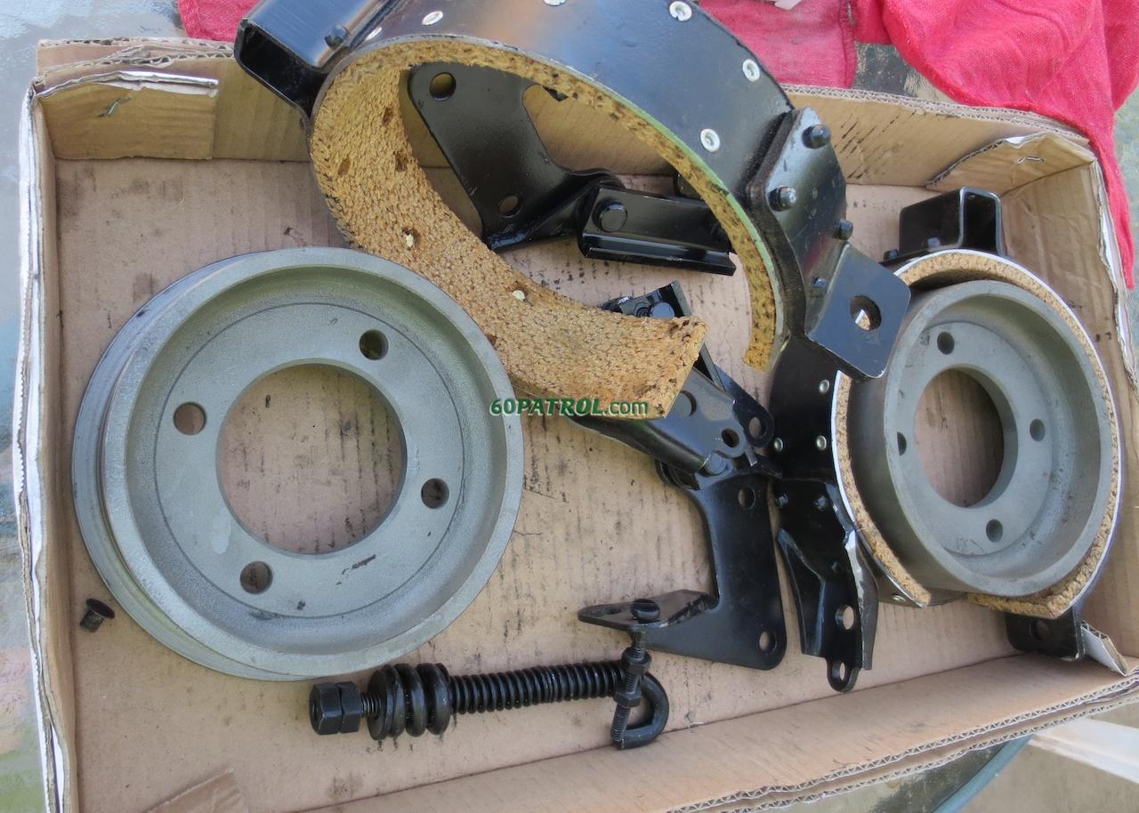

Of course, I nearly had to take a second mortgage for the parts (although it was for two Patrols worth of clutches, pressure plates, parking brake bands, parking brake drums and two new throwout bearings!)
Don't they look pretty? The dealer can still get the clutch disks... there is one is LA and one in Tennessee but they're pricy! $128 each. The nissan dealer says that the pressure plates may still be available, but it may take some time to get them... but then again, they may simply have not been removed from the system yet... $261.93 each! I'll stick with the rebuild!
Had the parking brake drums and bands rebuilt while I was at it...

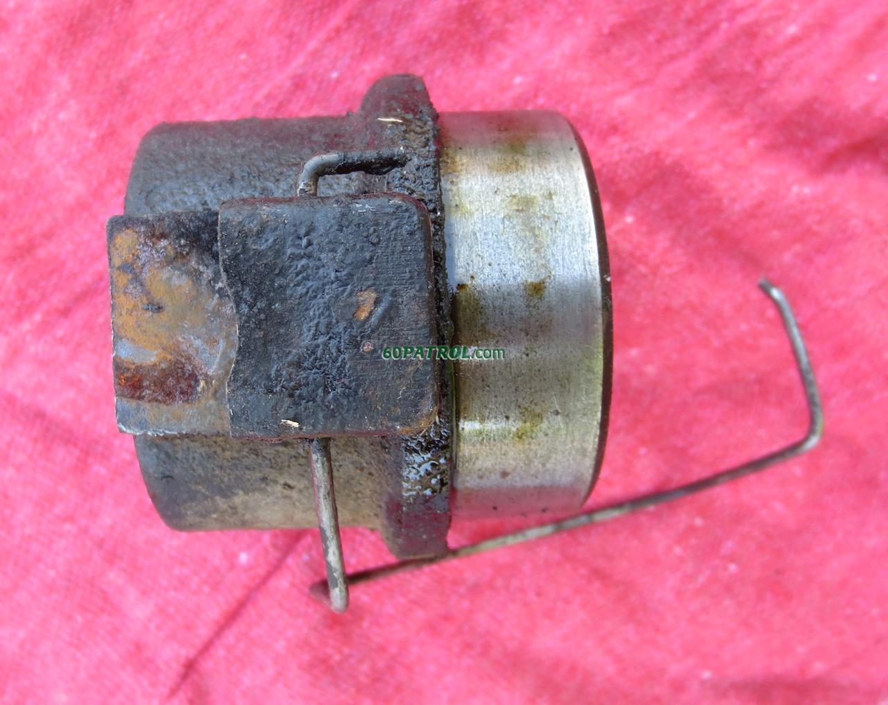

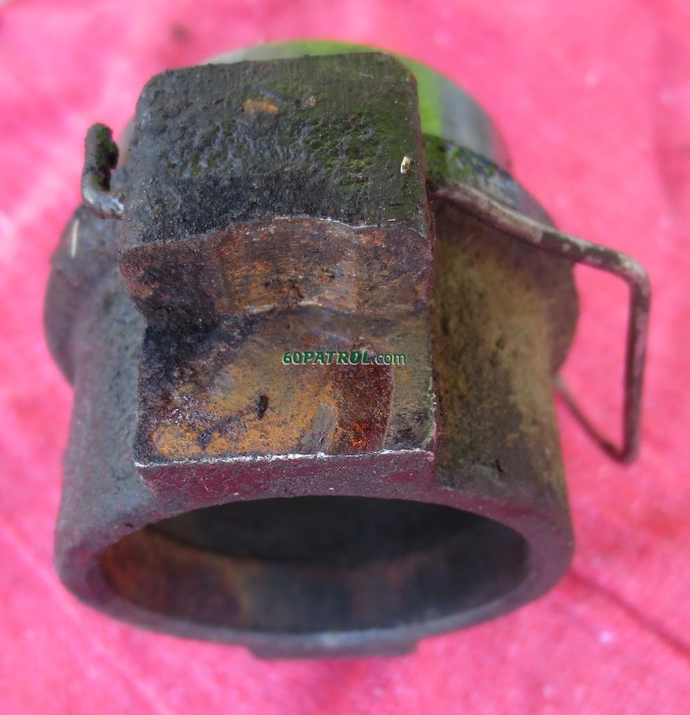

And the new throwout bearings... they are an off the shelf item PN#2065 for $33. The Nissan dealer can them for $56 each so I did okay here... assuming they fit!
Houston, we have a problem... The sleeve shows wear and needs to be welded up and reground flat. Dang. But, CapClutch will do them fairly inexpensively... I'll share next week.
My local Nissan parts department is fetching the little wire for the sleeve for $5 each... they'll be here late next week. Universal City Nissan in SoCal is sending me the pilot bushings $33 for two... delivered!
Anyway, that's the news! Have a great weekend!
