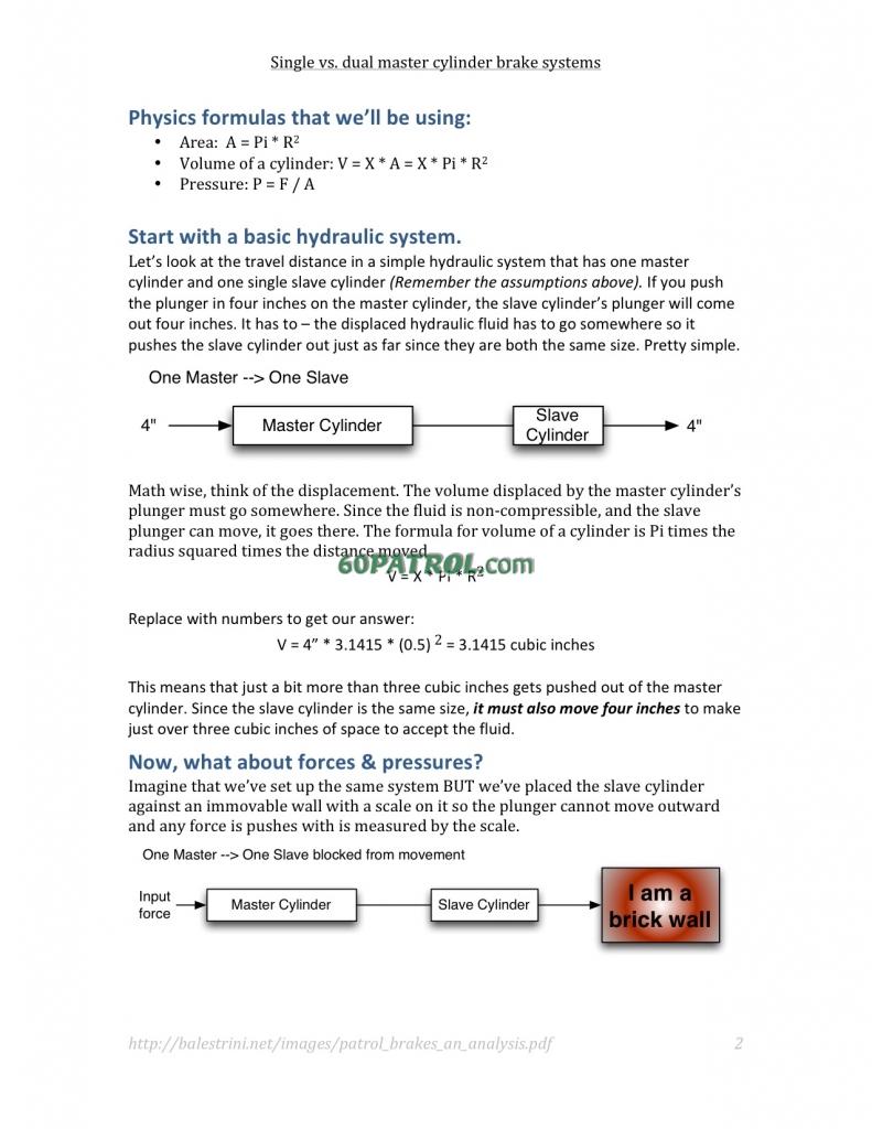

Howdy All,

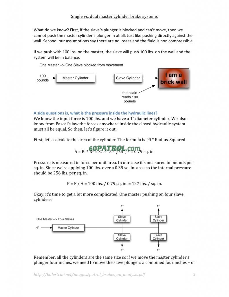

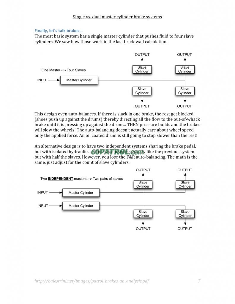

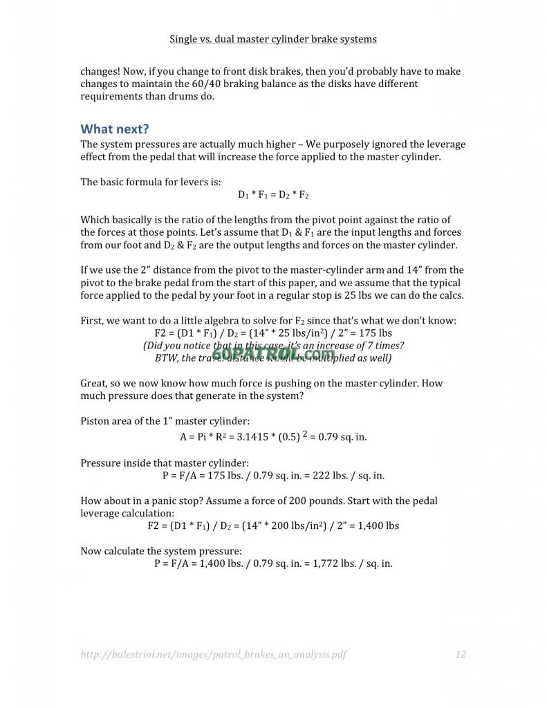

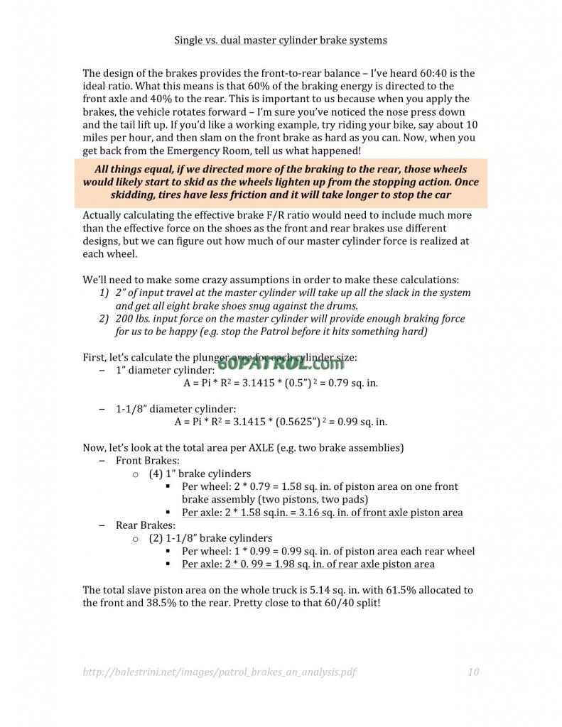

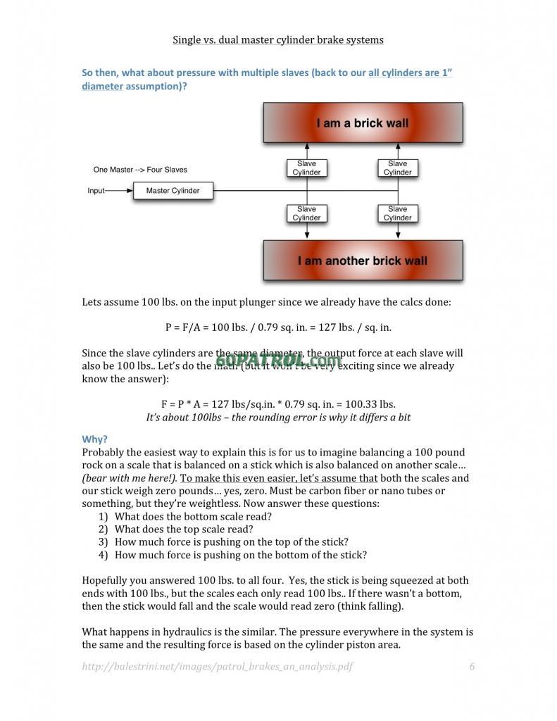

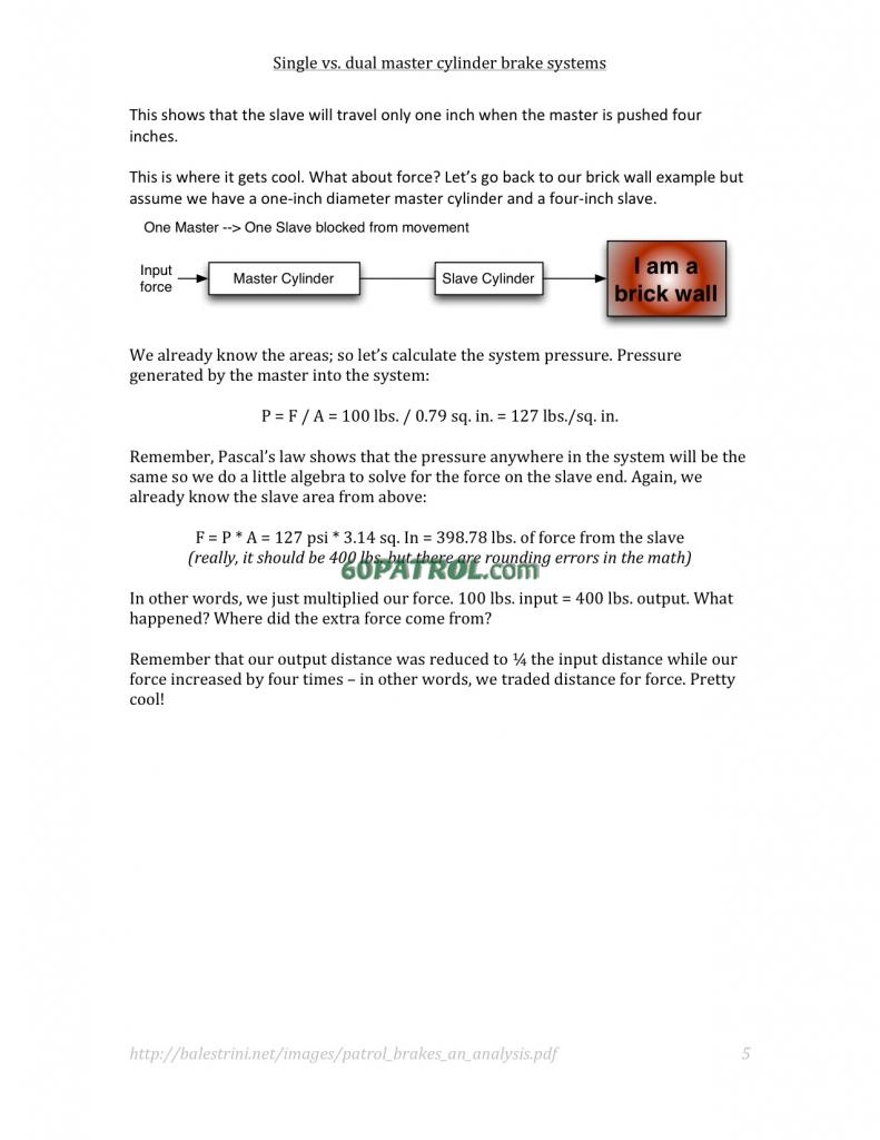

After my post earlier in this thread where I made some big mistakes, I wanted to figure out and understand the whole brake thing myself. In order to do this, I chose to write a paper on brakes. It turned out a bit on the long side (which fits with the honor of "most longwinded" that moore_rb has bestowed on me! ;-) ), but with any luck, it works its way through some basic hydraulic calculations and how they work in context of brakes. Anyway, you can download the pdf here (http://balestrini.net/images/patrol_bra ... alysis.pdf) if you want to read it in long form. And, just to be convenient, here it is in images.
I hope you like it (and maybe it's useful!)
John
3471
3472

Outstanding! Thank all of you - John, Esteban and Chris for all of the research and effort that went into this. I'll admit I only skimmed it for now, but I have yet to see anything this comprehensive regarding the Patrol braking system. :clap: :clap: :clap:

Very awesome writeup...!
And, I can say that I learned something - I was ready to jump on the fact that US Patrols have 1 inch rear wheel cylinders, and that the entire system is "square" ; but then I saw that the 1-1/8 rear cylinders are for MWB Patrols - interesting little factoid.
The dual reservoir cylinder in my post above is perfect for anyone who wants to convert their Patrol to a dual reservoir, but wants to maintain non-power brakes. I'll be adding my "How to" steps to this thread as soon as I make the conversion on my Patrol (it will probably be a couple more weeks)

I like the schematic depiction (page 8?) of the "slave" master cylinder being in series. It made what Esteban tried to tell me about why the pedal pressure and travel wouldn't change finally soak in. I submit.
