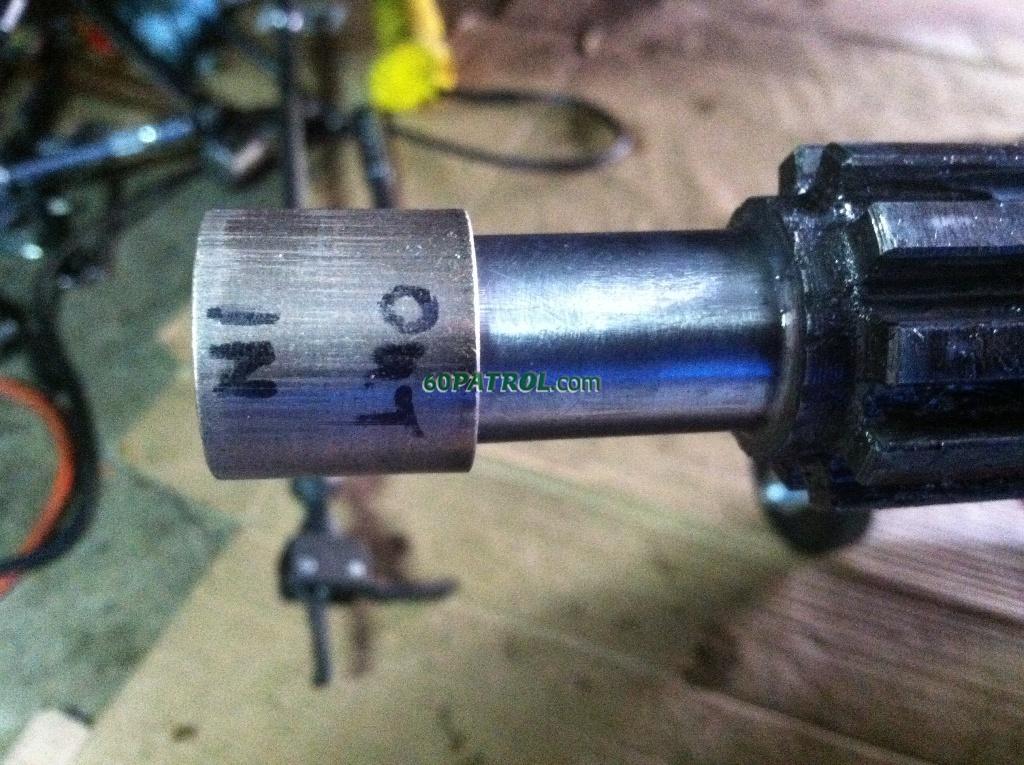

pulled out of the crank after being installed, the label "in" is the side inside the crank, and the label "out" is the side flush with the crank for the transmission input shaft. The bushing is crushed inward not allowing the input shaft.
