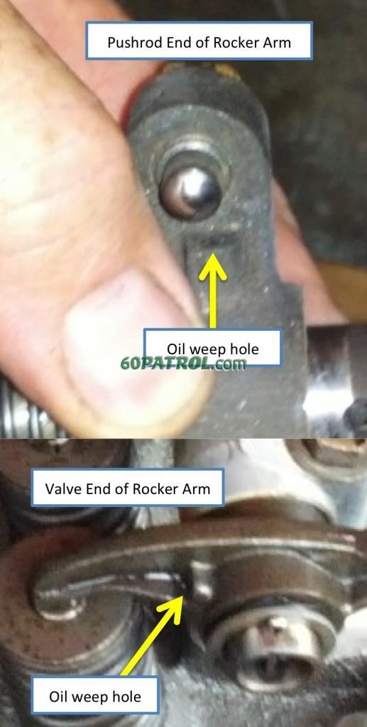

As for the top end oiling, I didn't pull the valve train apart, but I did slide a rocker out of the way and snap a picture of the rack that is for engine #2 -- Notice the grime trail extending each way around the shaft? Looks like the bushing should be grooved and have two holes so the oil can make it out the front and rear of the rocker. Can someone confirm? Just for giggles, I called the Nissan dealer and asked if they could get any rocker arm bushings (13260-58000) -- Nope.
3485
Here are the oil weep holes on the rocker arms. (sorry about the quality -- I had to crop way, way in to see them)

Just took apart a crusty assembly. This did not use any bushings on the rockers. The orientation of the oil holes on the shaft is down. The only shaft support with any oil connection is the end one with the slot-head screw. This screw is also tapered on the end to pin the shaft in place and ensures oil passage alignment.
Each rocker has an annular machined groove in its center as you suspected. The tiny hole which lubes the pushrod originates in that groove. The larger hole toward the valve originates about 1/8" away from the groove.
