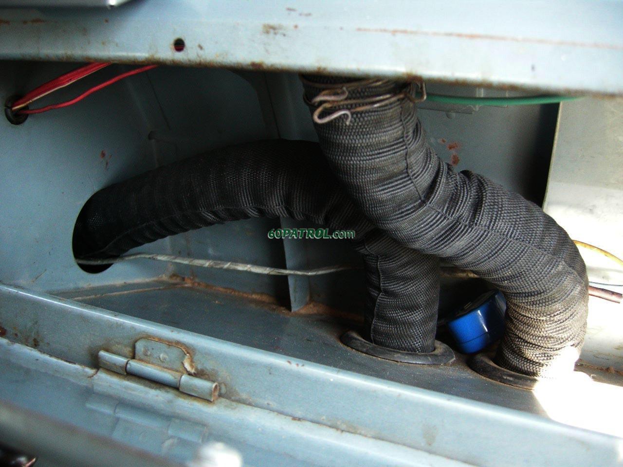

Post by bosque »
Just more shots of original equip. on a '65 I was into today......
