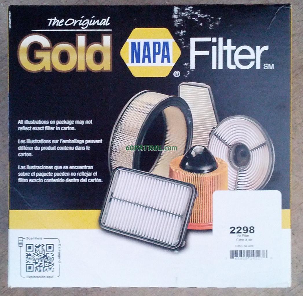

On a bit of a creative streak today -- That gooey oil bath air filter was too messy! So, I came up with a solution. Started with the sketch that Esteban uploaded awhile ago. One thing that I wanted was to keep the inner housing so the air filter element would not be visible from the outside. My goal was to make it look stock without the gooey mess.
First, I gutted the inner housing -- I should cut those sharp points off
3367
This is why I did made the conversion -- YUCK!
3363
This is the piece that makes the magic happen. I used a piece of 1/16" stainless steel I had lying around and my new, handy, dandy plasma cutter -- Cut a circle-ish to match the O.D. of the new air filter element.
3365
This is the filter that matched up to the housing best. I think it's from a racing lawn tractor or something...
3366
I enlarged the center hole on the inner housing so it will sit lower in the outer housing
3359
The plate sits at the bottom of the inner housing and provides a seal for the bottom of the air filter
3360
Now with all the pieces inside
3362
There it is! From the outside, it looks just like an original oil-filled air filter. A little paint and it's ready to install
3364
Was a great Patrol day -- we are really close to installing the engine!

now THAT is pretty snazzy.... 8-)
I might have to break out some copy-cat action on that one...

Good work with the filter, John, and the fact you're keeping the original look. :clap: :clap: :clap:
